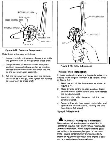

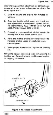

Fordiesel69 272 #3 Posted October 20, 2014 http://www.kohlerengines.com/onlinecatalog/serieslanding.htm?series=K-Series Gov needs to be adjusted. Share this post Link to post Share on other sites
876wheelhorse 46 #4 Posted October 20, 2014 ok how do i adjust gov there is a bolt where the cable goes do i move that over alittle ? and how? Share this post Link to post Share on other sites
Fordiesel69 272 #5 Posted October 20, 2014 K-series or Magnum? Share this post Link to post Share on other sites
pfrederi 20,675 #6 Posted October 20, 2014 If a K series. Share this post Link to post Share on other sites
Fordiesel69 272 #7 Posted October 20, 2014 If k-series, please do not mess with the gov shaft. Do everything else. Share this post Link to post Share on other sites
876wheelhorse 46 #8 Posted October 21, 2014 its a k series the arm goes all the way over to the stop and if i loosen that bolt what happens ? Share this post Link to post Share on other sites
Fordiesel69 272 #9 Posted October 21, 2014 If you loosen the bolt and are not familiar with engines, you can have a real mess getting it right again. You really can't feel what you are doing thru the pliers. Perform the adjustment per the manual on the cable / springs first. If you can't get it working, then maybe try the shaft. Share this post Link to post Share on other sites
