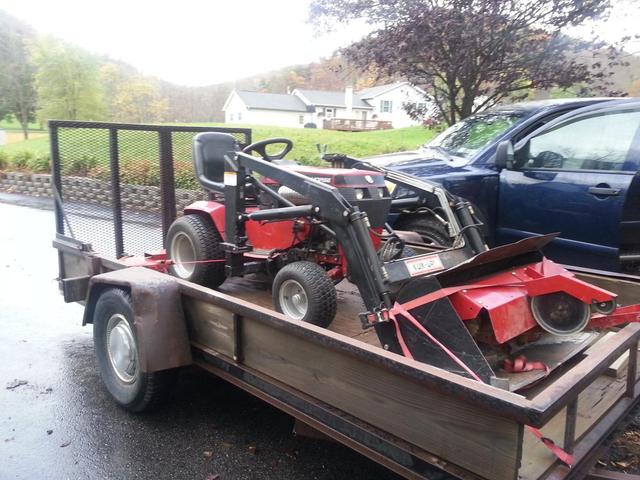

jmdavidh09 33 #1 Posted October 18, 2014 Snuck down to nittany lion territory this morning to pick up a 400hr 520 with a 48 deck, tiller and my first loader! I cant wait to play tomorrow once it gets a good service...... Share this post Link to post Share on other sites

jmdavidh09 33 #6 Posted October 18, 2014 (edited) Well....I have to thank my local dealer here; they gave me the heads up on it because I think the former owner called his local dealer to get an idea of value be for listing for sale. His dealer called mine for an idea of value because they know each other and I dont think too many of these were sold...then my dealer called me and said "hey, I know of a 520 with loader for sale....." So, long story short...it kind of fell in my lap..wasn't really looking for one but the price was fair and the owner had everything for all attachments. After using it to unload I can say it certainly isnt as capable as bigger machines (i have run many skidsteers and mid size tractors, loaders, etc) but it should be great for mulch next year and some other little tasks I have im mind....snow will be fun too if I need to stack this year. This tractor is definitely getting the "Matt's foot control" kit I have on the shelf. So far, im thrilled...I will clean it up and service it tomorrow then start posting questions.....like: 1. Anyone ever add a filter for the loader? 2. Anyone convert twin stick loader control to joystick? The current configuration reminds me of the 1960's case construction king we had for a yard machine at my old job! Anyway...thanks for comments and stay tuned! Edited October 18, 2014 by jmdavidh09 1 Share this post Link to post Share on other sites

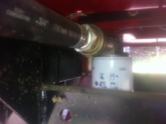

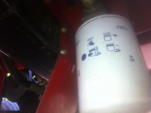

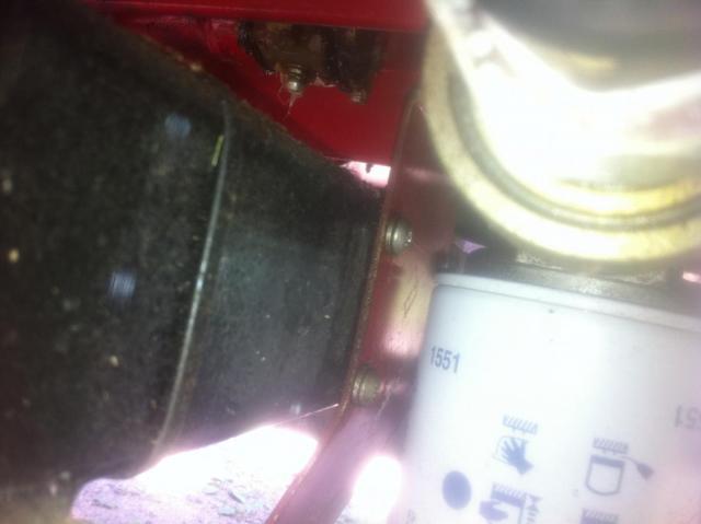

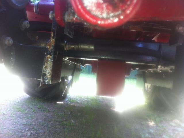

cheesegrader 436 #11 Posted October 19, 2014 My loader has a filter on the return line mounted under the tractor. FIlter base is from Northern Tool, and the filter is NAPA 1551. It is mounted to the undercarriage, and a very imortant part of the mount is the shield in front of the filter. 1 Share this post Link to post Share on other sites
