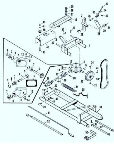

Gerry_D160 14 #1 Posted October 18, 2014 As you all know, parts are anywhere from hard, to impossible to find for these older models. I have the 6-7452, 48" snow thrower. The lift assist spring is missing. I have the owner's manual, which lists old part numbers and blow-up diagrams. I need the length and size, and any more info I can get in order to get as close a replacement as possible. The previous owner had welded a 5 1/4" pulley to the gearbox shaft. Does anyone know if this is the correct size pulley. I also need the length of the belt for this pulley. Thanks in advance for any help! Gerry Share this post Link to post Share on other sites

gwest_ca-(File Mod) 12,511 #9 Posted October 23, 2014 I believe this was the biggest and the last Garry 1 Share this post Link to post Share on other sites

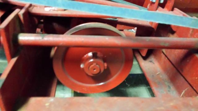

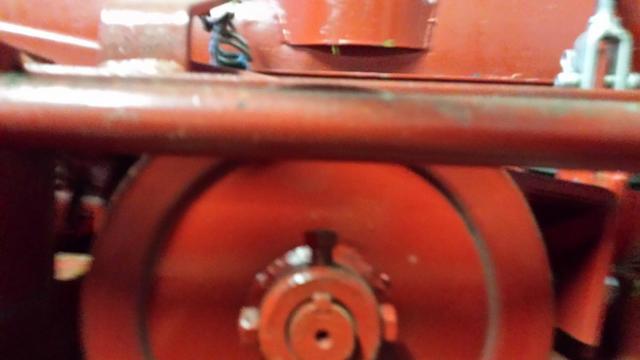

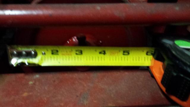

the_nite_owl 15 #10 Posted October 24, 2014 I took a look at mine and the pulley is 6" across unless you measure from the inside diameter of the groove? My snow blower is 48". Model 66-48ST01 . I will have to do some searching for the manual as all I could find here is the parts list. I seem to be missing the handle to rotate the chute as well but I have some other parts that were put aside somewhere I have to find still. Share this post Link to post Share on other sites
gwest_ca-(File Mod) 12,511 #11 Posted October 24, 2014 This is the only operator manual we have for this series of snowthrower Garry 1 Share this post Link to post Share on other sites
Gerry_D160 14 #12 Posted October 24, 2014 Thanks Garry - that looks like the manual I have, which is great for identification and location but not for sizes if I need to fabricate a piece or buy a close facsimile. Share this post Link to post Share on other sites

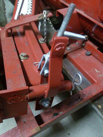

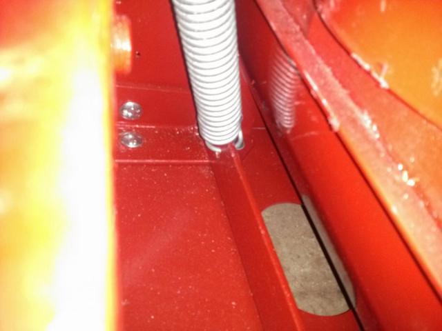

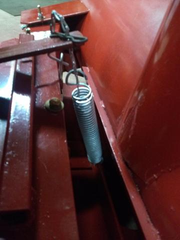

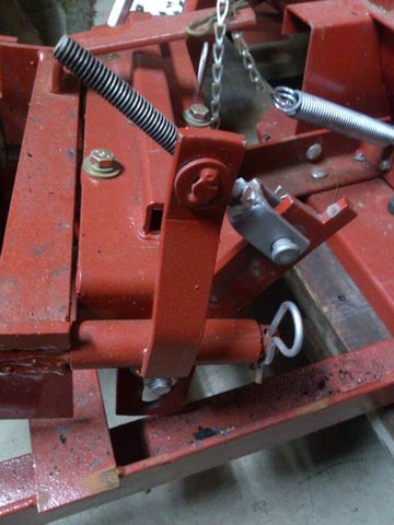

Trouty56 568 #13 Posted October 24, 2014 I'm on my phone now but I have photos of the spring attached to a previous post and am sure I mentioned the size....also I think it is the same as the spring on the 2 stage blower....the spring attaches to the bottom on the blower and then to a chain that is adjusted for length through a support on the mule.... Sent from where I am....... Share this post Link to post Share on other sites
Trouty56 568 #14 Posted October 24, 2014 Here are a couple pictures.... 1 Share this post Link to post Share on other sites
Gerry_D160 14 #15 Posted October 24, 2014 Thanks Bob for the pictures. My problem is that I don't have the spring and I need the dimensions so I can get a replacement. The manual shows the part, but no measurements. I have a handful of springs in the workshop, but I want to use one that has the proper tension characteristics. Share this post Link to post Share on other sites
Trouty56 568 #16 Posted October 24, 2014 I'll get you some measurements then.... 1 Share this post Link to post Share on other sites
Trouty56 568 #17 Posted October 25, 2014 8 inches long from end to end....1 1/4 inches wide.....1/8 inch wire.... Sent from where I am....... 1 Share this post Link to post Share on other sites
Gerry_D160 14 #18 Posted October 25, 2014 Fantastic! Thank-you for the measurements - that's just what I needed! Share this post Link to post Share on other sites

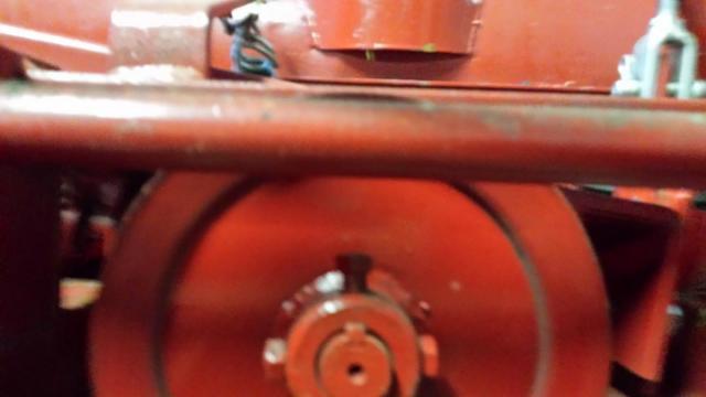

Gerry_D160 14 #19 Posted October 26, 2014 Bob, do you have measurements for the pulley and belt too? Share this post Link to post Share on other sites
Trouty56 568 #20 Posted October 26, 2014 Well...for now the 200170 belt is 53 X 1/2....next time I go to the shop I'll check that diameter....do you have to build the whole front mule???? Share this post Link to post Share on other sites
Gerry_D160 14 #21 Posted October 26, 2014 The belt info I found for my model on the Internet also lists a 53 inch, which seemed too long. The setup is a little different on my blower, I'm still waiting on a local machine shop to finish fabricating a pulley shaft on the right angle gear box for the blower. The shaft (which was previously replaced by someone with one too light) sheared off (Part 6). The pulley had also been replaced and I'm not confident that it's the right one either. Share this post Link to post Share on other sites
Trouty56 568 #22 Posted October 26, 2014 (edited) the pulley is a 6 inch one.....the belt I am using is 49 inches (I think this has come up before and I measured it).....here are some pictures...... The belt tightener.......as you can see there is a lot of space for adjustment..... Edited October 26, 2014 by Trouty56 1 Share this post Link to post Share on other sites
Gerry_D160 14 #23 Posted October 26, 2014 Thanks! This will be a HUGE help. I've looked everywhere for this info and it's hard to find. Thanks again for taking the time to add photos! Maybe I will have this thing ready for snow after all. Share this post Link to post Share on other sites
