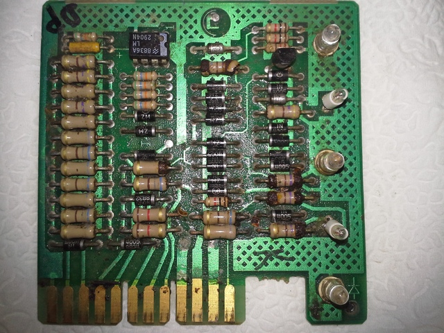

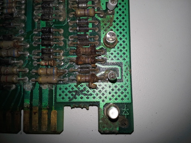

andy001 5 #9 Posted October 21, 2014 I think I found another issue with my board. .just not sure what they are called. .or what to tell the guy at radio shack I need. .what is the rating? Share this post Link to post Share on other sites
Save Old Iron 1,576 #10 Posted October 21, 2014 They are either 1/4 watt or 1/8th watt RESISTORS. They are color coded with bands indicating the resistor value. http://ece.ut.ac.ir/circuitlab/images/ResistorColorCodes.jpg If they are burned, the colors may not be clearly visible. Resistors burn when they have too much current flowing thru them (either wrong value lamps or a short circuit was present across the lamp contacts). Your board looks like a "new style" indicator board which I have never had a chance to investigate. Possibly if you posted a much clearer picture of where these resistors are located on your board, another member may be able to pick off the color bands from a good board. 1 Share this post Link to post Share on other sites

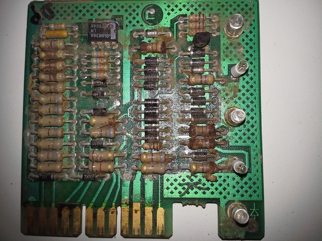

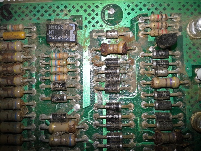

andy001 5 #12 Posted October 21, 2014 Here are better pics. .anyone have a thought? They end of the resistors in question are split open and slightly rusty Share this post Link to post Share on other sites
andy001 5 #13 Posted October 21, 2014 It appears I have to different size resistors that are bag..anyone see any other issues? Share this post Link to post Share on other sites

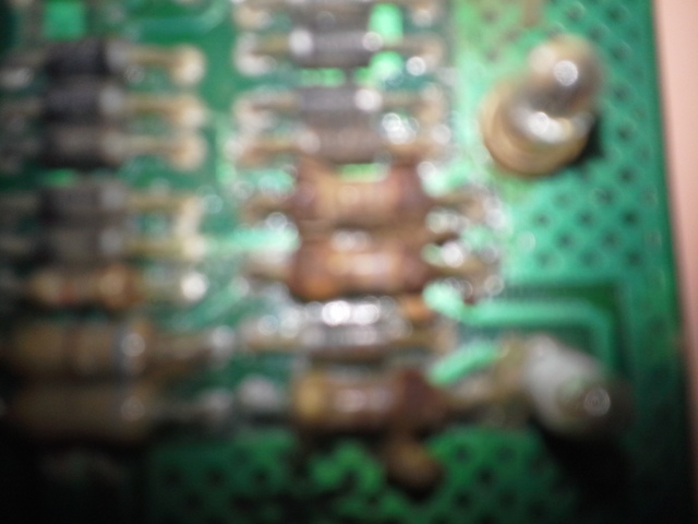

andy001 5 #14 Posted October 21, 2014 One more...also tried to hook up the tail lights last night. .key word tried. Are they powered through the circuit board? Share this post Link to post Share on other sites
Save Old Iron 1,576 #15 Posted October 21, 2014 wash both sides of the pc board with 91% isopropyl alcohol and scrub with a toothbrush to remove any residue. then retake the photos we may be able to see the color bands on the resistors more clearly. 1 Share this post Link to post Share on other sites
Save Old Iron 1,576 #16 Posted October 21, 2014 One more...also tried to hook up the tail lights last night. .key word tried. Are they powered through the circuit board? No. This circuit board is an INDICATOR board. It DOES NOT control any function of the tractor. The board essentially contains 4 or 5 little "test lights" hooked to various switches in the tractor. The on or off state of the lites indicate what position the safety switches or oil sensor switch are in when you try to start the tractor. This board in indeed the "newer" version. If we can get a good idea of the value of the resistors, the board can probably be repaired for under $10. 1 Share this post Link to post Share on other sites
Save Old Iron 1,576 #17 Posted October 21, 2014 The bulbs on this board appear to be red LED's, not grain of wheat bulbs like on the older version board. Remove the bi-pin bulb you have soldered in place and pick up red LED's (which are a standard item at RShack). 1 Share this post Link to post Share on other sites
andy001 5 #18 Posted October 21, 2014 Cool I will clean it. Keep in mind looking at board that the bulbs that are clear all way to the bottom are orig. I replaced two with 12 v 50ma bulbs geaino wheat style. My replacement and the top bulb work. Your right though. .come to think of it the top one I think is red. .dang it! I couldn't find solder in place red led at radio shack last time I was there Share this post Link to post Share on other sites
andy001 5 #19 Posted October 21, 2014 By the way. .how do I tell if my lights are led ? Share this post Link to post Share on other sites
Save Old Iron 1,576 #20 Posted October 21, 2014 (edited) Visual clues, LEDhttp://www.polytechnichub.com/wp-content/uploads/2014/10/led-light-mini.jpg Grain of wheat [incandescent] http://www.mindsetsonline.co.uk/Catalogue/ProductDetail/miniature-grain-of-wheat-bulb?productID=b3405ae4-8390-4db9-a6fd-7d4c47bf301b&catalogueLevelItemID=4daa4a6c-ead8-427a-bd21-51c004c7a32d plus the lower right corner of the board shows a diode (led symbol) http://www.clipartbest.com/clipart-9iRRraRnT under the lower indicator. Edited October 21, 2014 by Save Old Iron 1 Share this post Link to post Share on other sites

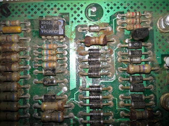

andy001 5 #24 Posted October 22, 2014 Ahhh ok. Here is the board after cleaning. .I tried to be gentle on it. Share this post Link to post Share on other sites
andy001 5 #25 Posted October 22, 2014 Thanks for the link. .I'll measure before I order Share this post Link to post Share on other sites
