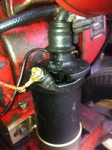

stevebo-(Moderator) 8,735 #1 Posted October 16, 2014 Today I tried to start one of my 702's to run treated gas through it but only to find no spark. Pulled the hood off to check for spark and upon inspecting the coil this is what I found. Wonder how this could happen? Any ideas? Anyone see this before? Looks like my kid hit it with a hammer.... Share this post Link to post Share on other sites
AMC RULES 37,259 #2 Posted October 16, 2014 (edited) Definitely doesn't look like it just happened all by itself. Edited October 16, 2014 by AMC RULES Share this post Link to post Share on other sites

stevebo-(Moderator) 8,735 #6 Posted October 17, 2014 There was no way to get to the coil as the hood was on it. It happened on it's own somehow? Maybe exploded? Share this post Link to post Share on other sites

bmsgaffer 2,071 #9 Posted October 17, 2014 (edited) Yea i would say the coil overheated. Assuming you didn't leave the key on: I'll bet the coil was failing internally (coils were shorting) and getting mighty hot, it probably blew right as you were shutting her down last time and just didnt notice it over the sound of the engine coming to a stop. Just a theory... At least it didnt look like this (about 0:15 when the boiling transformer oil goes): Edited October 17, 2014 by bmsgaffer Share this post Link to post Share on other sites

stevebo-(Moderator) 8,735 #11 Posted October 17, 2014 I need to buy a new coil. Everytime I go to buy one I get asked what type of coil? Forgive my ignorance here but I think they ask if I want an insulated or non insulated one? Anyone can help with what to ask for or perhaps a napa part number? Share this post Link to post Share on other sites
VinsRJ 723 #12 Posted October 17, 2014 I have seen these explode in the past... Share this post Link to post Share on other sites
km3h 543 #13 Posted October 17, 2014 Coils come in several voltages. Some require a ballast resistor. You want a coil for an early model GM car. 1975 Chevy will do nicely. Share this post Link to post Share on other sites
N3PUY 1,031 #14 Posted October 17, 2014 The coil I use is a TruTec # UC-15T. I pay $9.39 for that one. The Standard Motor Products # is UC-15 and is about $14.00 . You can get them at an automotive parts store. The coil actually states on it "NO EXTERNAL RESISTOR REQUIRED". Share this post Link to post Share on other sites

stevasaurus 23,738 #16 Posted October 17, 2014 I've seen that happen on cars from the 60's...I doubt that somebody hit that. Share this post Link to post Share on other sites
squonk 47,283 #17 Posted October 17, 2014 Napa IC 64SB internal resistor coil Share this post Link to post Share on other sites
stevebo-(Moderator) 8,735 #18 Posted October 18, 2014 Thanks guys!! I just bought one on ebay for $12 with free shipping !! Share this post Link to post Share on other sites
