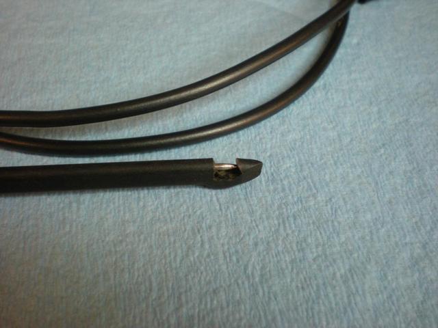

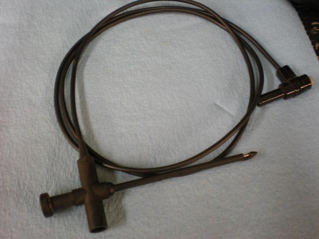

Geno 1,931 #1 Posted October 16, 2014 These are piercing leads for testing that I've used for many years. Just thought if you guys didn't know about them I would put one on here. You can hook it to a meter and go like crazy or put a test light into the banana plug end and do the same. Makes life fast and easy and does no damage to the wire. 3 Share this post Link to post Share on other sites
KC9KAS 4,746 #2 Posted October 16, 2014 For spark-plug wires? I would be afraid that with the high voltage going through a spark-plug wire there would be a spark from the piercing to ground. Is that a problem? Share this post Link to post Share on other sites
Geno 1,931 #3 Posted October 16, 2014 They are for testing for voltage and grounds. 1 Share this post Link to post Share on other sites
