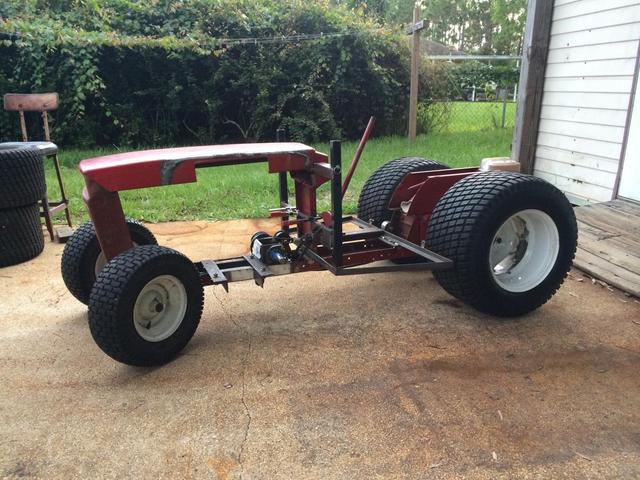

19richie66 17,950 #5 Posted October 16, 2014 I flipped the frame upside down on mine. Also made drop spindles and used a early 60's front axle. Its as low as I want it. I imagine low profile golf cart rear tires would give a little more in the rear. Compared to a stock height tractor. 9 1 Share this post Link to post Share on other sites

19richie66 17,950 #10 Posted October 16, 2014 I cut off the axle pivot plates and rewelded them to the bottom of the frame after I flipped it. It would have been dragging the ground if I left it stock. Share this post Link to post Share on other sites

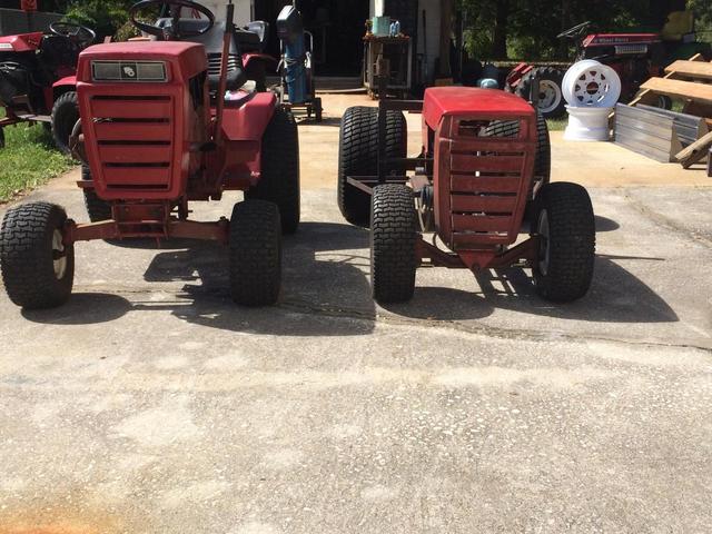

wallfish 20,736 #14 Posted October 16, 2014 (edited) I did what Richie did by adding the 60s front axel but instead of flipping the frame, cutting the axle pivot off to weld it back on, I cut the trans mount off, flipped that over and welded it back on to keep it looking stock Flipped the spindles on the 2 seater Edited October 16, 2014 by wallfish 4 Share this post Link to post Share on other sites

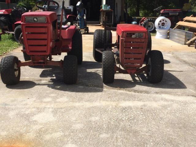

hcminis 1,818 #17 Posted February 2, 2021 (edited) Before and After. Built by Jon Bell Edited February 2, 2021 by hcminis 2 1 Share this post Link to post Share on other sites
