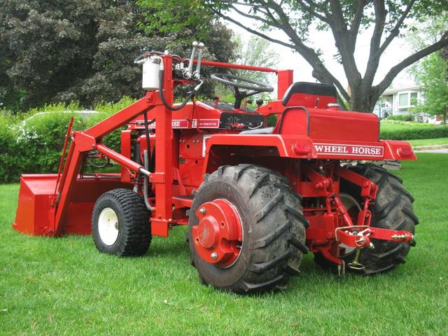

stevebo-(Moderator) 8,741 #6 Posted October 16, 2014 Moparharn- Obviously you would not do that. The loader IMO is worth$1000-$1500. The D with a bad rear end that needed to be rebuilt by a shop would cost at least $1000 - $1500. If it is only the hydro pump then it may be less. The question was asked how much do you think it would cost a shop to fix it. IF I were looking at that tractor I would walk away from it due to the cost to fix. My 2 cents. Lastly- in terms of value.. My restored d with loader in the pic above I could not sell for $2500 so I did a trade. That machine and loader was sandblasted, primed with gun and sprayed with a gun. It was mechanically right and looked really nice. 1 Share this post Link to post Share on other sites
moparharn 1 #7 Posted October 16, 2014 Your tractor is really beautiful. I would have paid $2500 for it. This tractor did not run well at low rpm and I am not sure that it was getting to its full high rpm. If the rpm is down some could it cause the hydro to squawk when you need traction? Should it spin the wheels at any rpm? Thanks again. Share this post Link to post Share on other sites
