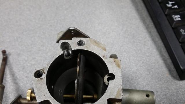

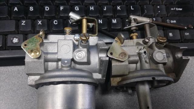

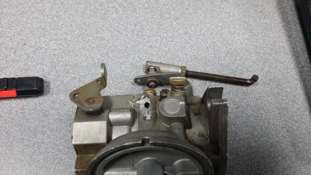

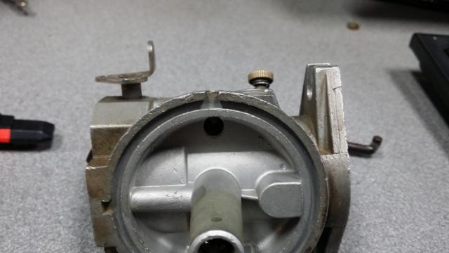

whtractors24 3,443 #16 Posted October 14, 2014 (edited) OK So I Dont Believe IT'S Grounds Ran + Direct To Coil STill Runs Like crap. Hers are the photos of issues I think no found the job weld I pulled off and found this hole that routes to the hole in the 2nd pic. The 3rd picture is where it looks like some one either tried to tap or thread something in the port. Edited October 14, 2014 by jason.c Share this post Link to post Share on other sites
diamondred 63 #17 Posted October 14, 2014 Thats an air passage. Per say, a float bowl breather. If the needle valve gets dirt in in it, or the float is water logged, the bowl will fill with fuel and come out of these holes. Check float by putting it in a cup with fuel and make sure it doesn't sink. Put it back together, with the carb in the working position, gravity feed some fuel into it and make sure the needle valve is doing its job. Share this post Link to post Share on other sites
whtractors24 3,443 #18 Posted October 14, 2014 Yes but thay whole is a lot larger that it is supposed to be it should be a pin size hole! Share this post Link to post Share on other sites
diamondred 63 #19 Posted October 14, 2014 I really don't think there is suppose to be a hole there. If so, I don't think they would have went to all the trouble to vent the bowl area to the end of the carb in pic #3. I would make sure the passage is clear and re-seal the hole shut so dirt don't get in the bowl. The air that comes into bowl ( if any), has come through a filter. ... I know .... I don't like giving up on stuff either.... so I keep fixin til its broke. Share this post Link to post Share on other sites
whtractors24 3,443 #20 Posted October 14, 2014 Your correct here is the new one just arrived no hole there! Share this post Link to post Share on other sites
