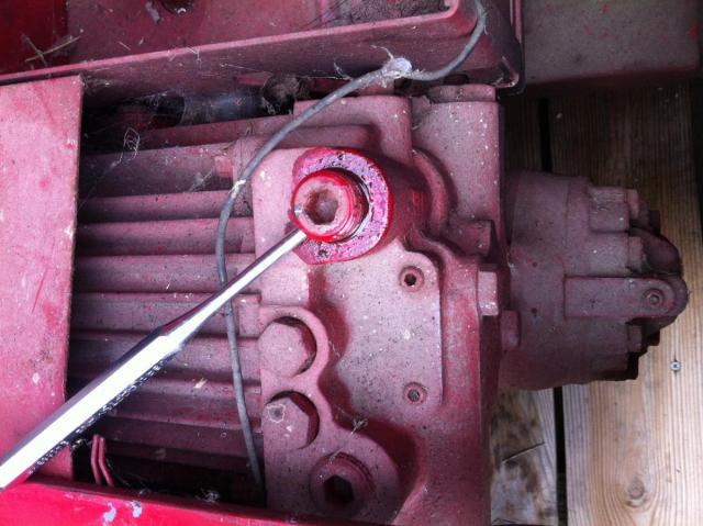

medman 4 #1 Posted October 12, 2014 How do I release the trans to freewheel on a charger 10? I think it's a 1972 has 10 hp kohler on it I loosened this but didnt help(see pic) Share this post Link to post Share on other sites

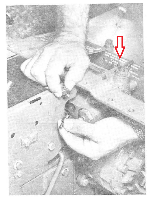

rmaynard 17,424 #2 Posted October 12, 2014 (edited) It's a bad picture, but the valve is located here: Counter-clockwise 1/4 turn if I recall. Edited October 12, 2014 by rmaynard Share this post Link to post Share on other sites
daveoman1966 3,884 #3 Posted October 12, 2014 You are missing the valve...it should look like this on the top of the Hydrogear unit Share this post Link to post Share on other sites
medman 4 #4 Posted October 12, 2014 doesent have one of those in it just a plug Share this post Link to post Share on other sites
Callen 64 #5 Posted October 12, 2014 You have an early one.. it is on the back right under that splotch on the wire. 1/2 or 9/16 head,don't remember which, just loosen it a bit and just snug it when you're ready to run it. 1 Share this post Link to post Share on other sites
medman 4 #6 Posted October 12, 2014 (edited) You have an early one.. it is on the back right under that splotch on the wire. 1/2 or 9/16 head,don't remember which, just loosen it a bit and just snug it when you're ready to run it. worked perfect thanks again i see you race karts too Edited October 12, 2014 by medman 1 Share this post Link to post Share on other sites
