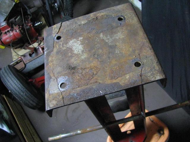

squonk 48,287 #8 Posted October 11, 2014 If you do enough to break a bolt you will probably crack the frame anyway. Share this post Link to post Share on other sites
AMC RULES 37,260 #9 Posted October 11, 2014 There were no broken bolts here... Share this post Link to post Share on other sites
