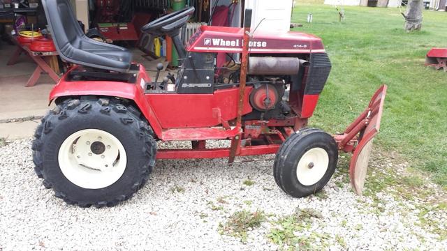

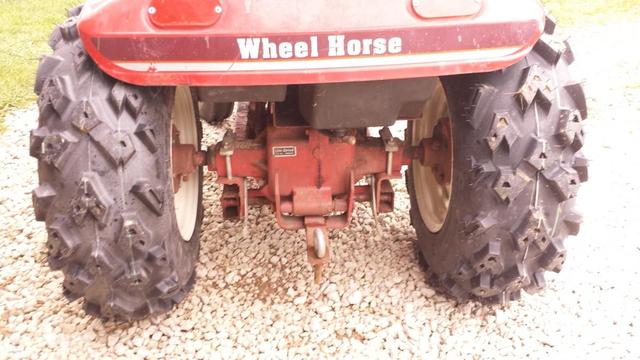

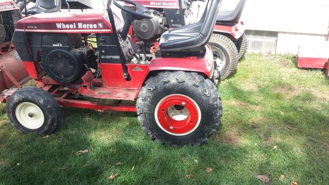

diamondred 63 #17 Posted October 14, 2014 (edited) Winter tires.... UTV tires 25x8x12 fit perfect. with weights... Edited October 14, 2014 by diamondred Share this post Link to post Share on other sites
WHEEL HORSE 312-8 52 #18 Posted October 14, 2014 Hell ya those r awesome Share this post Link to post Share on other sites
Kegler 68 #19 Posted October 15, 2014 Got a set very much like those with my 417H, Will have to take a closer look at them. Might decide to mount them. Share this post Link to post Share on other sites
