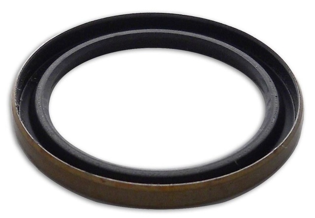

wake49 18 #1 Posted October 8, 2014 I bought seals to replace the old, worn-out seals at the axle, transmission pulley and brake housing. I cross referenced at the SKF site. I ordered 3 of the 9815 (which replaces the 1232 oil seal) and 1 of the 7410 (which replaces the 1303). My question is: which way do these seals install? My intuition tells me the concave part sits towards the transmission and the flat metal part is visible when installed. In the picture I included, I assume what is facing up faces the transmission. Can anyone verify that for me? 1 Share this post Link to post Share on other sites
rmaynard 17,634 #2 Posted October 8, 2014 You are correct. As pictured, that side goes toward the transmission. 2 Share this post Link to post Share on other sites
pacer 3,181 #3 Posted October 8, 2014 Yes, that goes to the tranny ... Use much care when sliding it onto the axle, the lip will tend to push out as you are working it on, kinda rotate the seal as you gently push it over the axle. Clean the axle stub with some fine sandpaper and lightly coat with some oil before... Share this post Link to post Share on other sites
