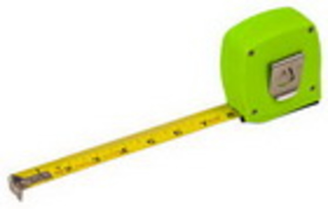

rmaynard 17,423 #25 Posted November 18, 2014 Knowing that the blade edge is 42" long, and that the holes are spaced at 9-1/2", and that it has a hole in the center, the 2" number can be arrived at by taking 42", dividing it by 2, subtract 9-1/2", subtract another 9-1/2" and the remainder = 2". ...or in my case, I just used one of these 1 Share this post Link to post Share on other sites
