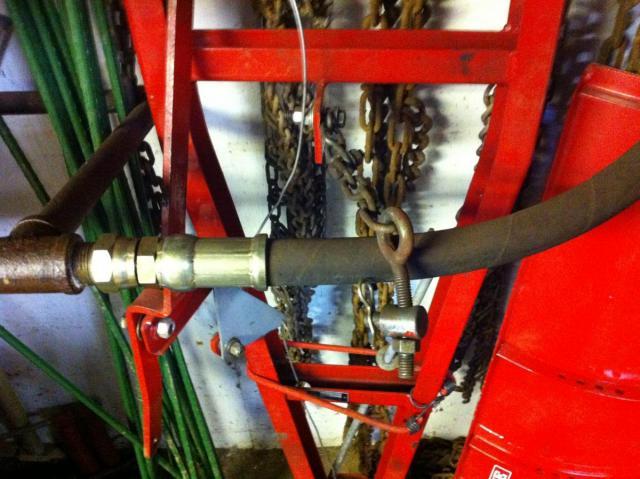

82Caddy 851 #16 Posted November 5, 2014 On this topic kinda since I started it... Top hitch attachment in this photo. I acquired an ATV salt spreader for free. Looks very similar to this: It works just fine but has a truck style attachment for the hitch. I could fab something up but lack the free time at the moment due to the new house and getting it ready for winter. It doesn't help that my new shop isn't wired up for 220 electrical. So my question is, has anyone used this style attachment before with a salt spreader or anything really? I figured if the rear end would hold up to the extra weight it would be ideal since the added weight of the salt plus fluid filled tires with chains and wheel weights would work out well for pushing snow around. Anyone see any problems with that style hitch attachment? Share this post Link to post Share on other sites
82Caddy 851 #17 Posted November 5, 2014 Nevermind...I searched around some more and found another way to modify things I already had to make my own. Just need to make a trip to my friends house to weld two pieces of angle iron onto the receiver hitch. Share this post Link to post Share on other sites
