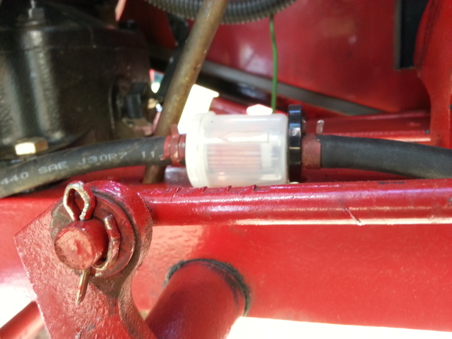

Dgibby 32 #1 Posted October 5, 2014 Hi to all! I recently got given a 314-8 that's in great condition and runs well but I notice a bit of a sputter. I little background on what I have done so far since I got it. change oil and gear oil, plug, air filter, fuel filter all the fuel lines, fuel shut off valve has been replaced, and the coil wire needed to be repaired. 2 things I noticed was.... 1. the fuel filter only as a drop of fuel in it even when it's running. Is that normal? My crapsman filter is full of fuel! And 2. the replacement plug that the Toro dealer gave me was a ngk. It calls for a champion and i know some engines are picky about plugs! Any help is appreciated thanks, Dennis Share this post Link to post Share on other sites
rmaynard 17,078 #2 Posted October 5, 2014 My filters only show a tiny bit of fuel as well. Sounds to me like it's time to pull the carburetor and do a complete cleaning. 1 Share this post Link to post Share on other sites
Geno 1,930 #3 Posted October 5, 2014 Best place to start. Share this post Link to post Share on other sites

Geno 1,930 #10 Posted October 6, 2014 (edited) In your opening post you said there was practically no fuel in the filter, is that still true? If so, start there. If you take the line off of the carb do you get a good stream of fuel? Always better to fix what the eye can see first instead of chasing after other things. Edited October 6, 2014 by Geno Share this post Link to post Share on other sites
Dgibby 32 #11 Posted October 6, 2014 (edited) Yes. Still only a little fuel in the filter. You can see very little fuel at the bottom. Edited October 6, 2014 by Dgibby Share this post Link to post Share on other sites
