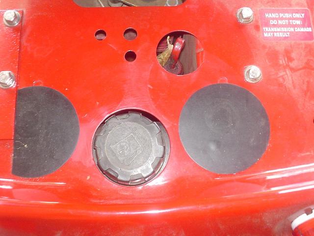

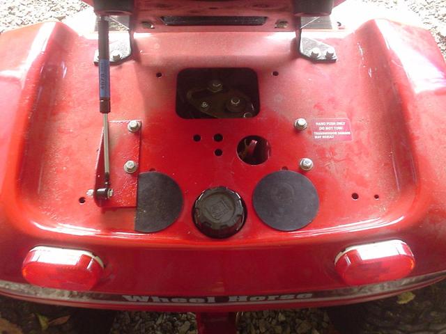

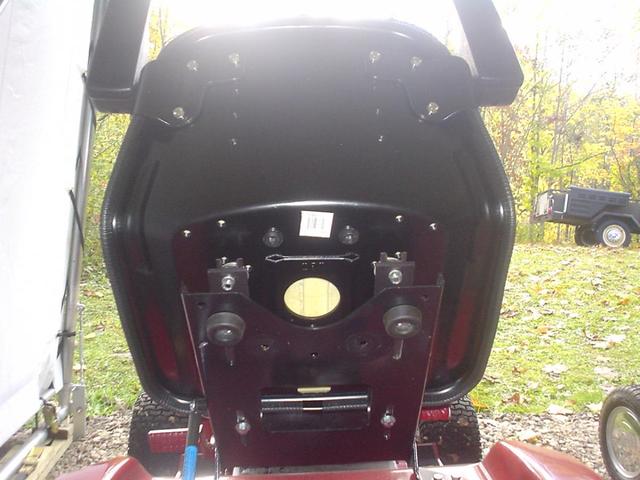

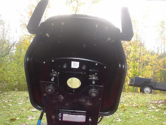

cleat 9,051 #1 Posted October 5, 2014 I moved the seat bumpers out to the seat slide/lower rear spring bolt. Makes the seat much more stable greatly reducing the loose rocking sensation. The coil springs are gone because I do not have seat switches. I also applied self adhesive rubber pads on the fender for paint protection. Cleat 2 Share this post Link to post Share on other sites

varosd 1,185 #3 Posted October 5, 2014 Where did you get the rubber pads? great idea. Share this post Link to post Share on other sites
cleat 9,051 #4 Posted October 5, 2014 Rubber pads are from work, they came in to protect some expensive pump seal parts but still had the adhesive protective paper intact. You could just cut some pads from rubber sheet material and stick it on somehow. Cleat Share this post Link to post Share on other sites
