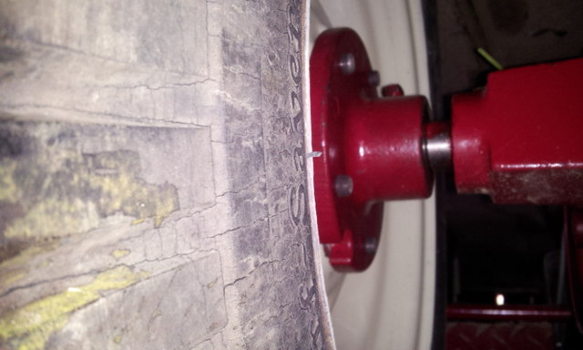

aboutime 9 #1 Posted October 5, 2014 I have a C/175. My rear hubs are always coming loose. Is there a secret or any trick that will help keep the hubs tight. I have tightened the sets screws but they always work loose. Share this post Link to post Share on other sites
Geno 1,931 #2 Posted October 5, 2014 I can't see from the pic but are the locking nuts also on the set screws? Share this post Link to post Share on other sites

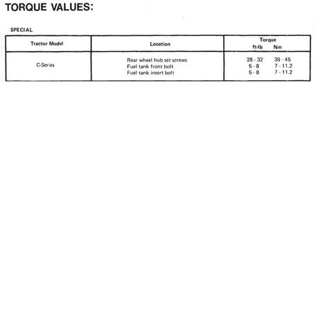

gwest_ca-(File Mod) 12,282 #9 Posted October 6, 2014 From the 1978-79 B, C and D-Series service manual Just snug up the lock nut to lock the set screw in place. Any tighter tends to pull the set screw back out. Garry Share this post Link to post Share on other sites

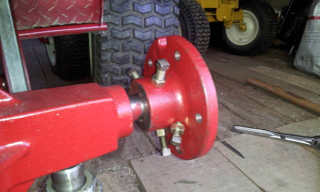

aboutime 9 #15 Posted October 19, 2014 Thanks for all the help. I finally got time to work on the hub. Anyway I drilled 3 holes and tap them I use 4 harden set screws and used a die grinder on the axle. Seems to be fixed. The reason one set screw Is at a angle is because the keyway is wore in the hub. 1 Share this post Link to post Share on other sites
Geno 1,931 #16 Posted October 20, 2014 Looks good to me, nice job. Share this post Link to post Share on other sites
meadowfield 3,028 #17 Posted October 20, 2014 Doesn't look like it will be coming loose anytime soon :D Share this post Link to post Share on other sites

Horse46 519 #22 Posted November 24, 2014 I have a question, why is there such a big gap between the hub and the housing.? Surely this would have the same effect as fitting spacers to a car hub to give it the wide wheel look, which can cause premature wear to bearing. Share this post Link to post Share on other sites
stevasaurus 23,712 #23 Posted November 24, 2014 Horse46...to answer your question...my opinion...the early horses (58/59 RJ's, Suburbans and most round hoods...the axles stick out enough to accept the hub with little or no space between the axle housing and the inside of the hub. In any case the hub should be mounted so it is flush with the end of the axle. When you get to the Commando's and such, the axle is longer, but the hubs are the same...this was done to make possible for wider tires (turf) and not hitting the fenders. I think that when you get to the "B" "C" & "D" series...those hubs become 5 hole and are a little deeper to get closer to the hub...but not always. Regardless, the length of the axles is to make possible the wider tires and not hitting the fenders. You may be correct, that the longer axle facilitates more stress on the inside and outside bearings...weather the hub is snug to the axle housing or has 1' or 2' of space. One thing...the early horses had 1" axles...the newer horses have axles that are 1 & 1/8". Just my 2 cents. Share this post Link to post Share on other sites
