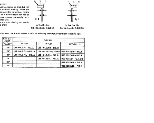

groundhog47 347 #3 Posted October 5, 2014 (edited) I can't find the particular post where one of the members submitted a drawing ( whclevishitchdwg.pdf ) and the one I'll attach may be it. (Thanks to member who originally posted this drawing.) Anyway with the bottom plow (with Brinly hitch and clevis used) you can adjust your track of cut with width of rear wheels. I'll try to insert pic of plow hitch adjustment. And you can keep you regular pull hitch in place. whclevishitchdwg.pdf Edited October 5, 2014 by groundhog47 Share this post Link to post Share on other sites
rollingflat 123 #4 Posted October 5, 2014 thanks for the pfd i can build one off that.! Share this post Link to post Share on other sites

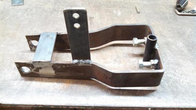

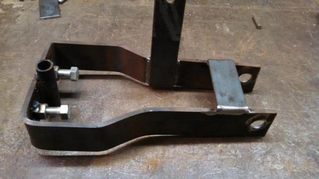

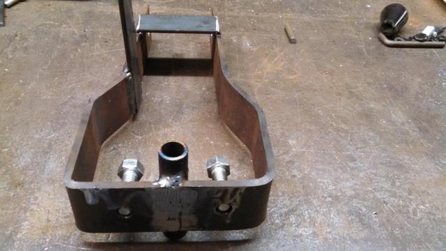

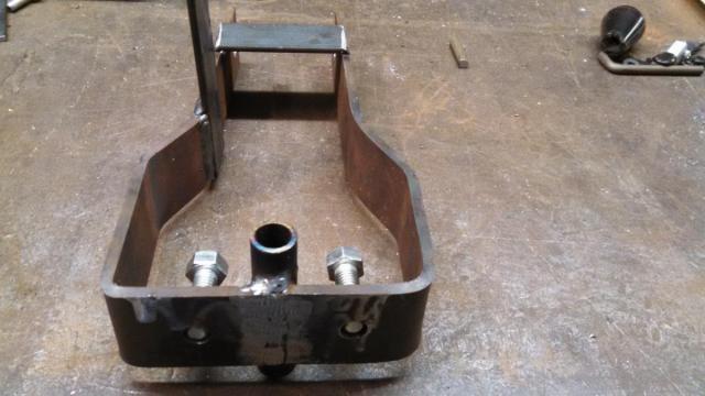

rollingflat 123 #6 Posted October 6, 2014 ]well, heres my first go only needs spacers at tractor connection point and some paint. if you can see in pics the bends on the left are tighter than on the right...that is the difference between cold bend and using heat. well, heres my first go only needs spacers at tractor connection point and some paint. 2 Share this post Link to post Share on other sites

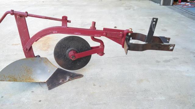

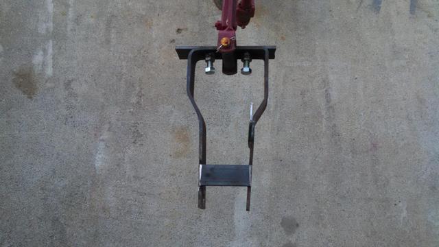

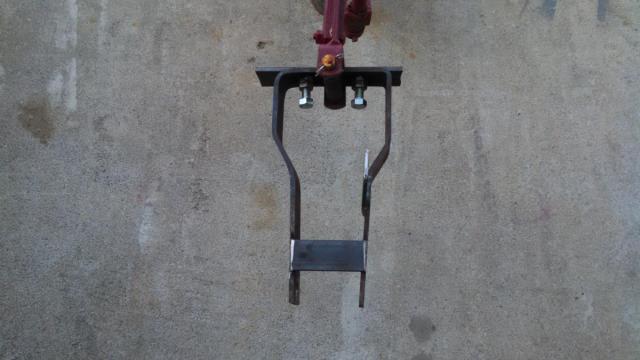

rollingflat 123 #7 Posted October 6, 2014 here it is mounted on my garden plow, had to make a spacer to fit between pin to tighten bolts aginst. But looks good will try it out w the boy later today. any idea what brand and size plow this is? Share this post Link to post Share on other sites
groundhog47 347 #8 Posted October 6, 2014 (edited) No idea on plow brand. ***On hitch, don't forget spacers between holes for tran mounting rod/shart. The second hole in lift arm is where I have to mount for a C-series, didn't come on early hitches, was a later mod as was strap across back which is very beneficial if you wish to leave clevis and draw hitch attached together. Very good lookin' work, saved a ton-o-$$$. ***See you already mentioned that !! Edited October 6, 2014 by groundhog47 Share this post Link to post Share on other sites
CasualObserver 3,406 #9 Posted October 6, 2014 Plow is from a Simplicity walk behind tractor. You can measure it across like this..... 3 Share this post Link to post Share on other sites
