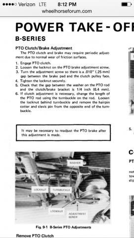

Tankman 3,528 #4 Posted October 4, 2014 are you sure it is not the p.t.o spinning ? Tightened up on the PTO brake a bit. Stopped most of the spinning noise. What's the proper way to adjust the PTO brake. I did know but, older now, forgot the distance. I'm thinking 10-thousands of an inch? Share this post Link to post Share on other sites
Aldon 4,834 #5 Posted October 5, 2014 I think the procedure is in link below which I snagged from an older thread on PTO brake question: Share this post Link to post Share on other sites
Aldon 4,834 #6 Posted October 5, 2014 (edited) Section 9 says .012" for C series. Edited October 5, 2014 by Aldon Share this post Link to post Share on other sites
