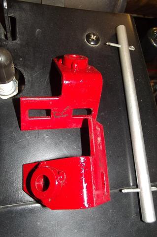

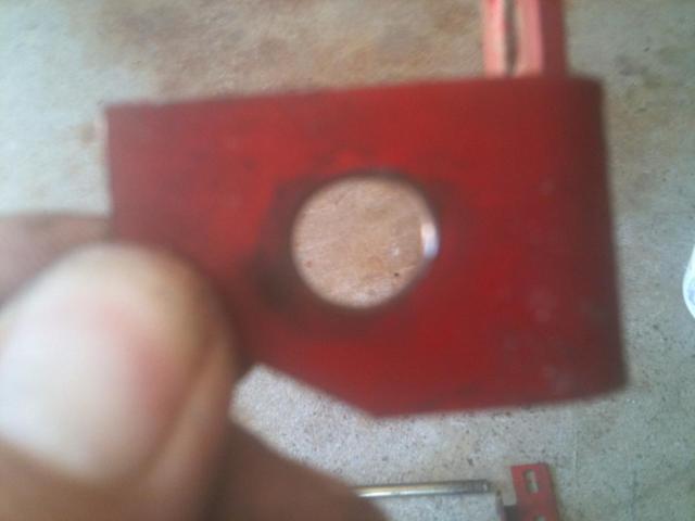

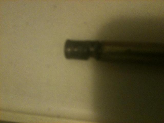

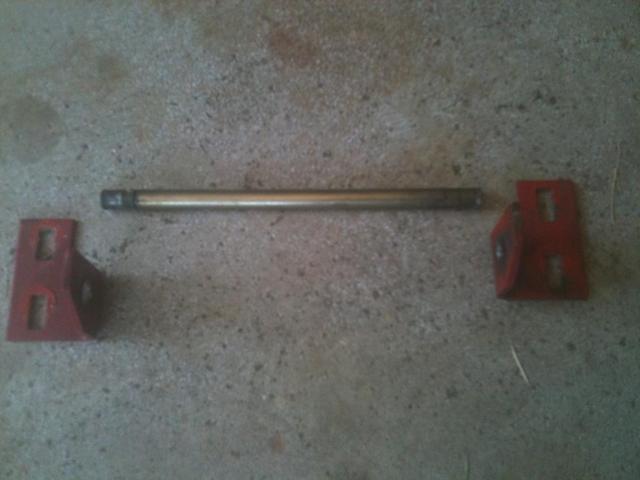

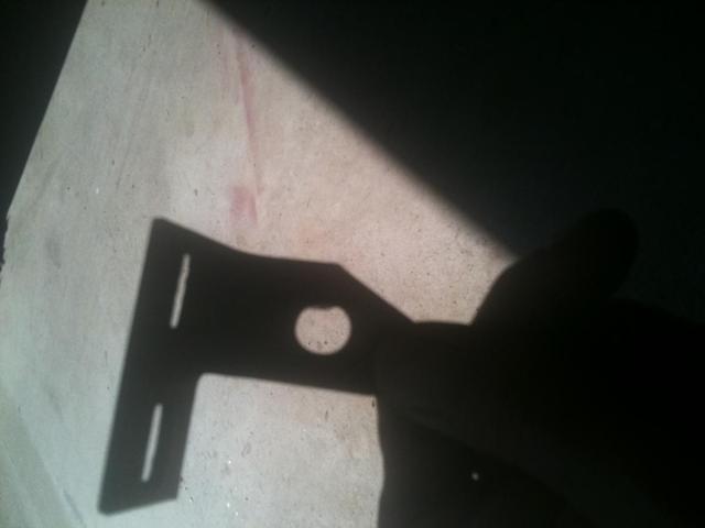

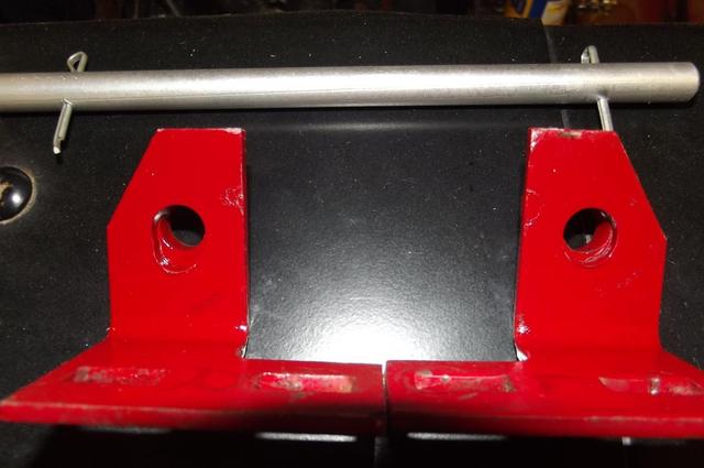

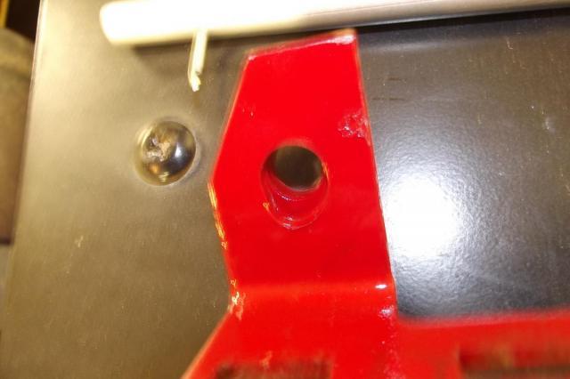

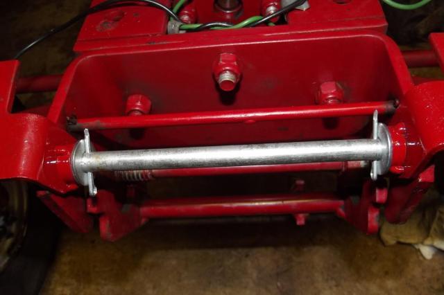

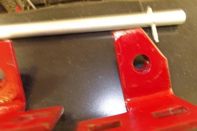

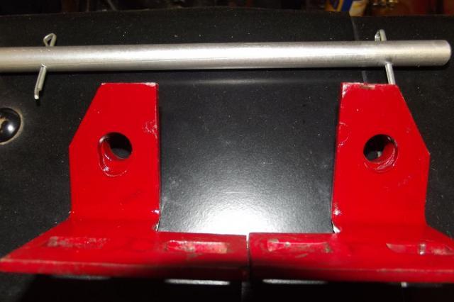

BOWTIE 226 #1 Posted October 3, 2014 (edited) SEEMS LIKE MOST OF THE 300-400 AND 500 TRACTORS THE HOOD HINGES ARE SHOT. THEY CAME WITH NYLON SLEEVE BUSHINGS THAT WORE OUT OT MISSING WITHIN 300 HOURS. THIS IS HOW BEEN REPAIRING THEM FOR NOW. THIS IS THE 1992 310-8 I BOUGHT JUST A FIVE DAYS AGO. THE STEEL BRACKETS WERE EGGED OUT AND MY STEEL ROD WAS GROOVED BAD. I JUST USED A PIECE OF 3/8" OD STEEL DOWEL ROD AND SOME 3/8" ID STEEL BUSHING AND WELDED THEM IN PLACE, THEN I COTTER PIN THE ROD. HERE SOME PICTURES. BOWTIE IN OHIO Edited October 3, 2014 by BOWTIE 9 Share this post Link to post Share on other sites

CTBT&D 77 #6 Posted October 3, 2014 I repaired two of the four I currently have. My pins were fine, the nylon bushings were gone. I bored and reamed the bracket holes to 1/2" and put in a shouldered sintered bronze bushing. The hardest part was cutting the bushing to approximately 1/4" long. I like your idea also, should last at least 40 or 50 years. Nice job. 1 Share this post Link to post Share on other sites

PaulC 342 #10 Posted October 3, 2014 Nice job!! Does this prevent the hood rattle? I ended up drilling mine out and putting in small bronze bushings and then used 3/8 hex head bolts with nylock nuts and washers. My hood vibrated a ton and this really cut all of that out and now it opens and closes like the hood of a car!! Share this post Link to post Share on other sites
Lane Ranger 12,161 #11 Posted October 3, 2014 Great job on the hood hinge repair Bowtie! I had the same problem on a 312 I repaired this summer. I had the egg shaped hinge parts and the 3/8 rod had worn down too! I used a new 3/8 rod and cut grooves in the 3/8 rod for the e rings . I was surprised to see Toro no longer sold the replacement hinge pieces so I just JB Welded heavy duty washers on the hinge pieces and put everything back together after taking the hood and hinges it all off the tractor. Share this post Link to post Share on other sites
Tankman 3,528 #12 Posted October 3, 2014 Nice repair on the hood hinges. Have run into the same problem numerous times. Didn't do a great job but, drilled out the worn holes and used sleeves w/ shoulders. The bearing (or sleeve, whatever I used) is available at Lowes or Home "Cheapo." Again, excellent repair. You should offer them for sale in the classifieds. Share this post Link to post Share on other sites
