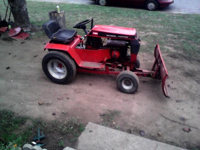

WHEEL HORSE 312-8 52 #4 Posted October 2, 2014 I measured its 11/8 Share this post Link to post Share on other sites
gwest_ca-(File Mod) 12,519 #5 Posted October 2, 2014 According to an original parts list the 1994 312-8 model 73362 uses 1-1/8" axles with 4 pinion gears in model 92-8707 transmission. The online parts lists at Toro show the 92-8707 transmission using 1-1/8" axles with 8 pinions which is transmission model 92-8708. I tend to believe the original parts list for the 73362. Garry Share this post Link to post Share on other sites
