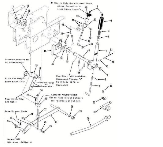

Kpro 3 #1 Posted September 28, 2014 When I bought my tractor there was not a bolt connecting the chain to the arm. When setting it up for a mower deck, which hole on the arm and which link do I put the bolt through? Thank you Share this post Link to post Share on other sites
gwest_ca-(File Mod) 12,511 #2 Posted September 28, 2014 Hope this helps Garry 1 Share this post Link to post Share on other sites

skrusins 128 #6 Posted October 1, 2014 I have a 1990 312-8. I looked the lift manual because the will not lock in place without me pulling up on the rod. The manual on this sight looks the same. My problem is the lift handle is solid their is no number 8 button plug. Is there another type of arm that they use so I could take it apart. I did sprayed PB Blaster for a few days because it was really bad. Just need a little spring action. Hope someone can help. Thanks Share this post Link to post Share on other sites
gwest_ca-(File Mod) 12,511 #7 Posted October 1, 2014 I think that button plug just makes it look pretty. The #4 spring is likely broken. Pull #7 cap and #6 grip off and you should see it captured between #5 spiral pin and #3 spring retainer. Garry Share this post Link to post Share on other sites
skrusins 128 #8 Posted October 3, 2014 Thanks Alot Garry. It work exactly as you described I never took one apart before that really helped. Stan Share this post Link to post Share on other sites
