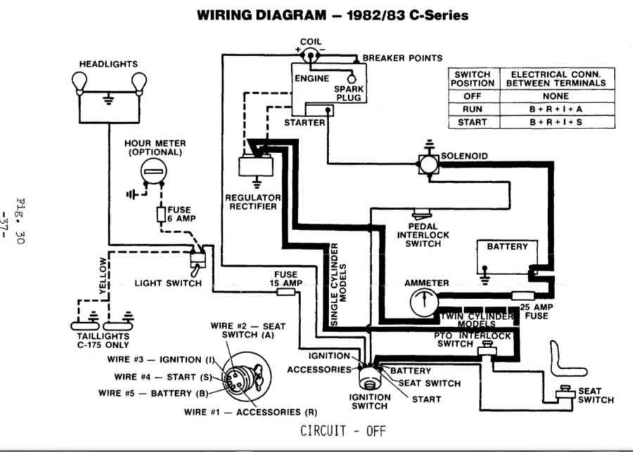

Geno 1,931 #16 Posted September 29, 2014 (edited) Start from the beginning. Is there power to the B terminal? There is a fuse and the amp gauge to check too. Edited September 29, 2014 by Geno Share this post Link to post Share on other sites
Butch 194 #17 Posted September 29, 2014 Start from the beginning. Is there power to the B terminal? There is a fuse and the amp gauge to check too. I'll check tomorrow. Your schematic is different than mine. The ignition markings are different and I don't have a push button starter. Share this post Link to post Share on other sites
KyBlue 655 #18 Posted September 29, 2014 I don't have a push button starter. The drawing isn't showing a push button starter. They just didn't include a key in the switch. On the inset drawing of the ignition switch you can see a key sticking out. Share this post Link to post Share on other sites
Trouty56 568 #19 Posted September 29, 2014 (edited) __A __R Manual says A is the Seat Switch and R is Accessories. The "R" contact is not contacting any other contact which tells me it's dead. __I __B __S Sorry...wasn't sure of the layout....but I would focus on the B, S, and I....and then....A goes straight to the lights, R straight to the reg..... Geno's schematic is good.... Edited September 29, 2014 by Trouty56 Share this post Link to post Share on other sites

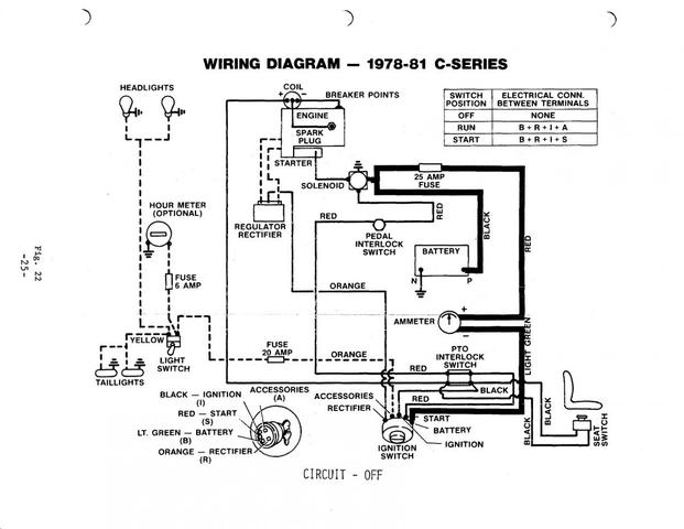

Racinbob 13,040 #20 Posted September 29, 2014 4Star is correct. That's a 3 position switch. Is there some way you can pinpoint what year tractor you have? The schematic shown is for the 78-81 C series. The C 85's were newer. Where did you get your schematic? Are you sure it's the correct one? Trying to troubleshoot from two different schematics can be bad news. You're saying the R terminal is never showing continuity with another terminal but that it's the accessories terminal. The 78-81 schematic has the terminals as per what Trouty56 posted. We just need to make sure we're all working off the same, and correct, schematic. Share this post Link to post Share on other sites
Racinbob 13,040 #21 Posted September 29, 2014 Sorry...wasn't sure of the layout....but I would focus on the B, S, and I....and then....A goes straight to the lights, R straight to the reg..... Geno's schematic is good.... Bob T, you were right, per the schematic. We just need to make sure that's correct for Butch's tractor. It sounds like it's not or he has the wrong schematic. Share this post Link to post Share on other sites
Trouty56 568 #22 Posted September 29, 2014 (edited) I was looking at an 83 schematic....downloaded from here....it does say A is seat switch and R for accesories....I guess the 2 could be interchanged but the switch cuts off the A during the start so the lights are not drawing starting power... Edited September 29, 2014 by Trouty56 Share this post Link to post Share on other sites
Racinbob 13,040 #23 Posted September 29, 2014 (edited) I think that's the correct one Bob and not the 78-81. But it also shows an ammeter and not a voltmeter like Butch said he had. I just feel that the correct schematic needs to be determined for certain so we're all on the same page. Edited September 29, 2014 by Racinbob Share this post Link to post Share on other sites
Trouty56 568 #24 Posted September 29, 2014 I see why the A and R are reversed.....sorry butch....got sidetracked..... Sent from where I am....... Share this post Link to post Share on other sites
Butch 194 #25 Posted September 29, 2014 The drawing isn't showing a push button starter. They just didn't include a key in the switch. On the inset drawing of the ignition switch you can see a key sticking out. Duh! My bad! Share this post Link to post Share on other sites
