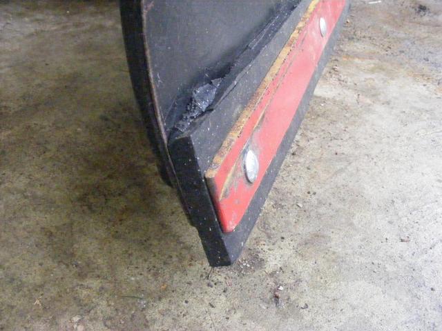

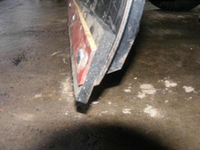

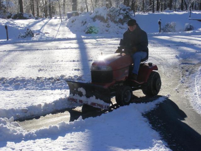

shallowwatersailor 3,222 #3 Posted September 27, 2014 I used this last winter made from a horse mat from TSC because I plow my neighbors driveways as well as mine, and two had serious $$ repaving done last year. It worked well and was cheap. But that plow was sold and replaced with a genuine Toro Wheel Horse plow for this year. Now I have done work on my driveway so I will need to duplicate it plus make skid strips from a cutting board for my snowthrowers. And in action. It still clears all but ice. 2 Share this post Link to post Share on other sites
rmaynard 17,643 #4 Posted September 27, 2014 I use the 1/4" steel edge that came with the plow. I have an asphalt drive. No marks from the plow, but the chains do mark the driveway a bit. I've flipped the edge once, and just ordered a new one last week as mine had worn quite badly. The two edges of this plow have lasted since 1984. Nothing against your rubber edge John, but I can't see it lasting more than a season on my drive. Share this post Link to post Share on other sites

RMCIII 840 #11 Posted September 30, 2014 Hey John: I like that idea... I am wondering if TSC has that stuff in different thickness..... Taper an edge on 1 side and wha-la, rubber blade for a snowblower! Rob Share this post Link to post Share on other sites

shallowwatersailor 3,222 #14 Posted September 30, 2014 Hey John: I like that idea... I am wondering if TSC has that stuff in different thickness..... Taper an edge on 1 side and wha-la, rubber blade for a snowblower! Rob Rob, The mats are 1/2" thick for cushioning the horse's hooves in a stall. I think that the snowthrower edge is at a greater angle of attack so I'm not sure if that would be what you want. The skids are what really ride on the surface. When I check out my walk behind for the season, I use a 1/8" thick paint stirrer for a gallon can for setting the height. FYI: The stirrers for the five gallon pails are about 1/4" thick. Easy-Peasy measuring! John Share this post Link to post Share on other sites
