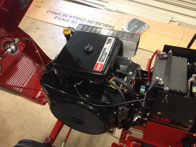

Martin 2,134 #9 Posted September 27, 2014 (edited) looking at the is pic its right above the fuel pump and just left of the fuses. right on top of the rear cylinder shroud where the red wire is curving around to a terminal........ heres a slightly better pic. the regulator is right at the bottom of the pic.... Edited September 27, 2014 by Martin 1 Share this post Link to post Share on other sites
