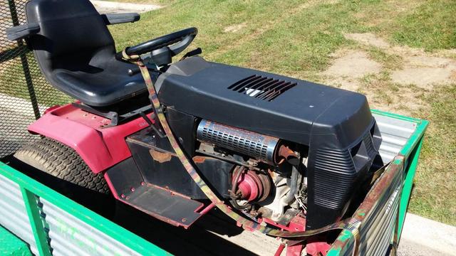

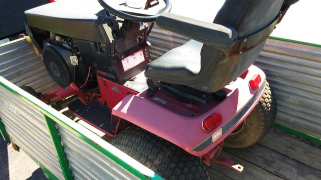

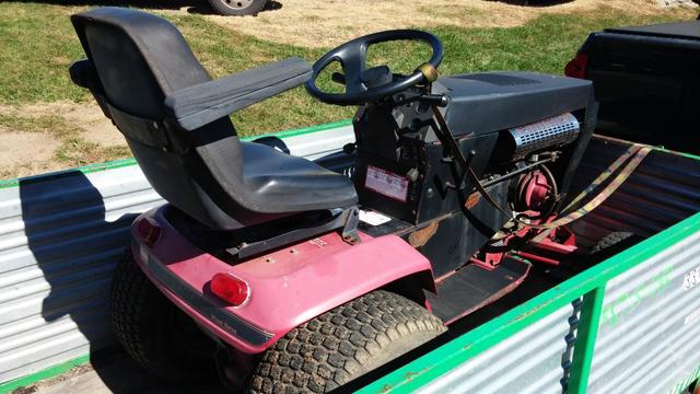

bmsgaffer 2,071 #1 Posted September 24, 2014 Many of you know of Geno and his massive collecting effort, but few of you are as affected as those of us that live within a few hundred miles of him! (I have much respect for Geno, but I have to rib him a little! ) Despite that fact, I was able to wrangle me a horse today (it helps that it was closer to me). Real nice fellow that used to use it to cut his yard but hasn't needed it in a couple years. Its not the prettiest but it is solid. 1991 520H, 683 hours. 7 Share this post Link to post Share on other sites

AMC RULES 37,260 #7 Posted September 24, 2014 (edited) Look at the first pict...see those eyes? Poor can't wait to get off that JD trailer. Nice score Brandon. Edited September 24, 2014 by AMC RULES 1 Share this post Link to post Share on other sites

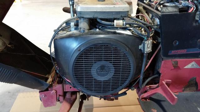

bmsgaffer 2,071 #11 Posted September 24, 2014 Yep! She fired up the first try with a jump. It currently suffers from the hunting problem, but I think a good carb cleaning and fresh gas will take care of that no problem. It sounds strong. With some persuasive wiggling I got the motion control lever to move forward almost all the way (It suddenly broke free while wiggling and I left skidmarks! Hydro = strong). Still working on reverse but I brought some good liquids today to help getting everything moving. 1 Share this post Link to post Share on other sites
kudzu3 323 #12 Posted September 24, 2014 Better lock it up tight, Geno could be on the prowl 1 Share this post Link to post Share on other sites

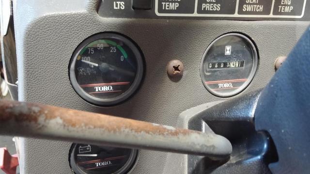

bmsgaffer 2,071 #13 Posted September 24, 2014 Shes starting to run real good. There is a slight hint of surging, but I haven't burned through the old gas yet. I put some additives in it to help clean it up as its used up. All the levers are moving smoothly. No lag getting the hydro going. Missing a Brake pedal return spring. Some wiring issues as the tach, fuel gauge and volt meter dont work (and I see some chaffed-bare wires in the harness that are just asking for trouble). Also may need a rectifier/regulator as I get a good voltage from the stator but it doesn't seem to be charging the battery (12.5v running). The only I can see at all seems to be coming from the oil drain pipe right at the cap so that should be quick and easy. The hydro is dry. Bad news is that some of the sheet metal is rusted far more than I expected. I don't know if the metal can be saved with anything but a complete tear down if that. Share this post Link to post Share on other sites
Geno 1,932 #14 Posted September 24, 2014 Just bought a regulator for another one last week. http://www.amazon.com/dp/B0081S8PD2/ref=pe_385040_30332190_TE_3p_dp_1 Share this post Link to post Share on other sites

bmsgaffer 2,071 #21 Posted September 25, 2014 Proof of life! (warning: 4 minutes of listening to an Onan and watching me steer around a parking lot) 1 Share this post Link to post Share on other sites
Geno 1,932 #22 Posted September 25, 2014 I hope we are. Of course if you start trolling Eastern Pa or Md, that might change. I might have to send my cousin Guido to pay you a visit. I'm going to near eastern PA in a few weeks to see Bob (Trouty), I better start searching up there, wouldn't want to come home with anything less than a full trailer load. Proof of life! (warning: 4 minutes of listening to an Onan and watching me steer around a parking lot) Where did the rest of the tractor go? 1 Share this post Link to post Share on other sites
bmsgaffer 2,071 #23 Posted September 25, 2014 I'm going to near eastern PA in a few weeks to see Bob (Trouty), I better start searching up there, wouldn't want to come home with anything less than a full trailer load. Where did the rest of the tractor go? I bought the cheapest battery I could find on my way back from picking it up and then realized that the positive would only reach if i put the terminals towards the back of the tractor. Those hoods have that funky sloped cover over the battery so if I tried to put the hood down it would try to start a fire across the two battery posts. Safer for me AND the hood if I just took it off until I got the correct battery. The tractor is actually sitting in an empty warehouse at my work, it hasn't even made it home yet. I have to finish working on my walk behind mower so there's room in my garage to put it. Should be coming home and making the neighborhood tour on Friday at the latest. I'm itchin to get some degreaser on it and pressure wash it. Share this post Link to post Share on other sites
