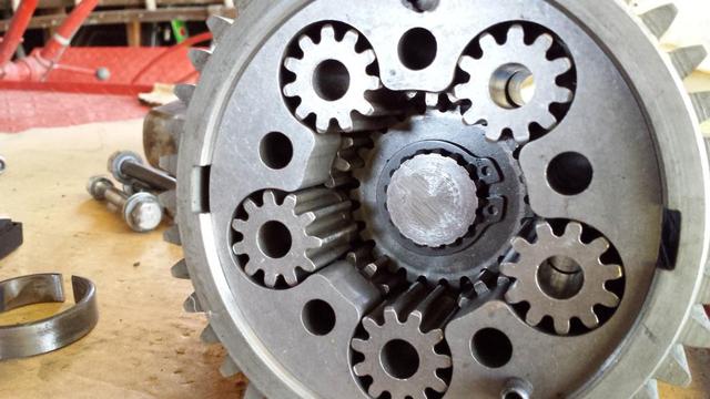

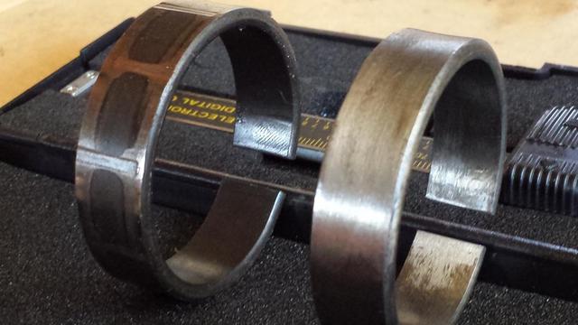

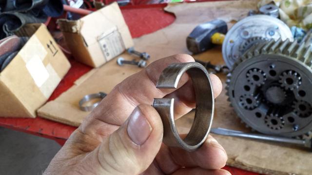

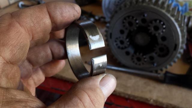

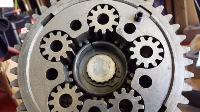

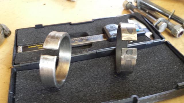

diamondred 63 #1 Posted September 20, 2014 (edited) Home made 7235 spring... hand worked spring steel , hardened and tempered. Edited September 20, 2014 by diamondred 4 Share this post Link to post Share on other sites

tombr77 5 #3 Posted January 7, 2017 Hi - I may give this a try , - do you have the dimemsions? i havent opened my 5060 yet, wanted to have a plan to have replacement 7235 before i do. Maybe make the new one first. Any other tips / etc... Did you anneal material, machine the ring to size, cut & expand, then harden & temper? Share this post Link to post Share on other sites
