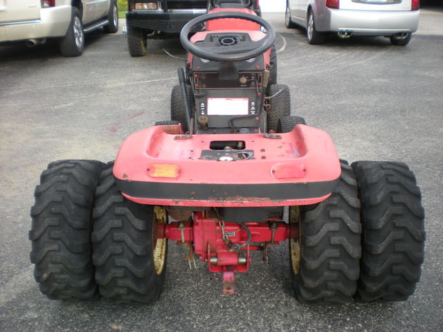

Geno 1,931 #5 Posted September 17, 2014 Skid steer 6 plys on the rear should take care of the rear. Deestone makes a cheap front 4 ply ag tire that should help on the front too. You don't need 4, it's just the only pic I have of them here. 1 Share this post Link to post Share on other sites
