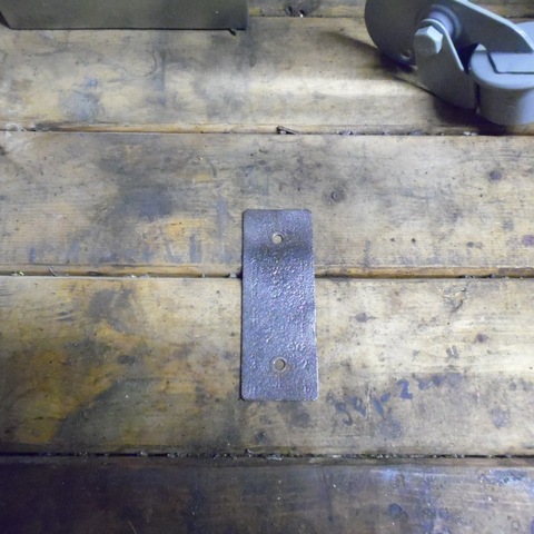

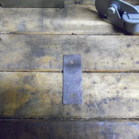

Molon_Labe 731 #1 Posted September 16, 2014 (edited) Last week I was talking with Terry about decals for my 400 Suburban and he asked about the serial number. I told him there was just a rusty plate where the serial number should be. After the call I decided to take another look at the rusty plate so I removed it from the tractor and put it under a lighted magnifier. There were numbers stamped in the rust and pitting along with choke throttle and shift pattern! I can make out 5 digits starting with 23. Does that sound right? Below is what I have to work with.. Edited September 16, 2014 by M_Bailey 1 Share this post Link to post Share on other sites
gwest_ca-(File Mod) 12,518 #2 Posted September 16, 2014 Have seen model 400 serials range from 21900 to 37875. Garry 2 Share this post Link to post Share on other sites
Molon_Labe 731 #3 Posted September 16, 2014 Thanks Garry!! Now I have the original serial number for Terry. Share this post Link to post Share on other sites
Geno 1,932 #4 Posted September 18, 2014 Have you tried rubbing a black marker over it lightly, without filling in the low spots to see if you can see more of it? 1 Share this post Link to post Share on other sites
Molon_Labe 731 #5 Posted September 18, 2014 Have you tried rubbing a black marker over it lightly, without filling in the low spots to see if you can see more of it? Geno, as a matter of fact I used Birchwood Casey gloss black gun touch up paint on it to pull the numbers out. Turned out to be serial # 23443. 1 Share this post Link to post Share on other sites
Racinbob 13,242 #6 Posted September 18, 2014 I was going to suggest the little modification Terry did for me on the decal but you did better by pulling out the serial number. Share this post Link to post Share on other sites
Molon_Labe 731 #7 Posted September 19, 2014 (edited) Bob I couldn't believe the numbers came off that piece of rust they were as clear as day after applying the paint. I am a happy camper!!!!! Edited September 19, 2014 by M_Bailey Share this post Link to post Share on other sites
Racinbob 13,242 #8 Posted September 19, 2014 I wish I would of thought of doing that. I even have some of the Birchwood Casey stuff. I tried everything I could think of. You done good!! 1 Share this post Link to post Share on other sites
