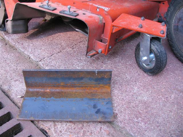

pacer 3,180 #4 Posted September 15, 2014 I've had this problem on most of the decks I've had and after many frustrating hours trying to correct it, I tried this solution and solved it!! I now have a similar set-up on all 4 of my decks (this is on a Kubota, I dont have a pic of one of the horses) Share this post Link to post Share on other sites
slammer302 2,157 #5 Posted September 15, 2014 Adding extra rollers is a great idea you might make sure the tires are all aired up and at the same pressure Share this post Link to post Share on other sites
silverbullet02 0 #6 Posted September 16, 2014 Thanks guys! I was leaning toward wheels on the front, but I really like the caster wheels idea. That'll be an easy little project. Share this post Link to post Share on other sites
pacer 3,180 #7 Posted September 16, 2014 OK, -- a couple pointers on doing the casters. Dont go too small on wheel size or width, they will tend to dig in, I had a bunch of 3" casters and mounted a couple of them and while I could see the concept was good on smooth ground, they tended to dig in on rough ground and turns. I have settled on 5"dia, 2" width (from HF) .... but, all my decks are 48" and that brings up another pointer - you have to pay attention to the front wheels having clearance in turning when you get in the larger diameter wheels. In that pic of the Kubota, that was the first one I tackled, its a 6" caster and it had clearance, no problem. But, when I did a 48" deck on a horse I couldnt use a 6" wheel and dropped back to a 5" and still had to do a bit of trial and error before I got it right Share this post Link to post Share on other sites
