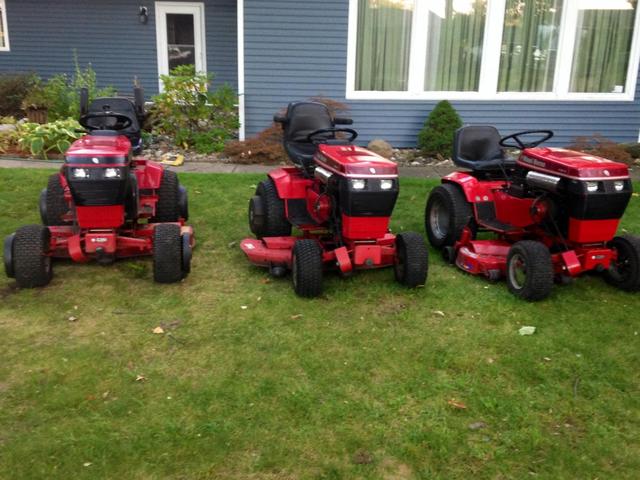

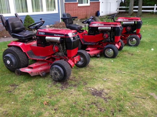

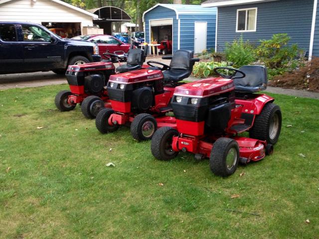

Dhodge 530 #1 Posted September 15, 2014 Worked on the 520H I purchased yesterday as it was missing pretty bad. Last night I thought I had a bas head gasket on the rear cylinder, however I took a good look at it this morning and seen some blow by around the rear intake manifold. Took the muffler and tin off to get to it and removed the manifold to find the gasket was shot. Installed a new intake manifold gasket and presto, problem solved. Mowed my lawn and clean her up a bit. I had two others out playing so I took a picture of the three I had out today. 520H, 520H and a 418A. My other 520H didn't get to play today, she's getting ready for surgery. 6 Share this post Link to post Share on other sites
