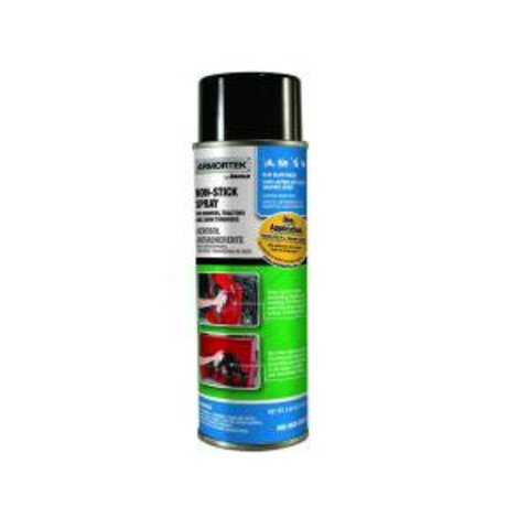

Cutlas3391 776 #12 Posted September 21, 2014 Armortek Non-Stick Outdoor Power Equipment Spray Share this post Link to post Share on other sites
