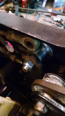

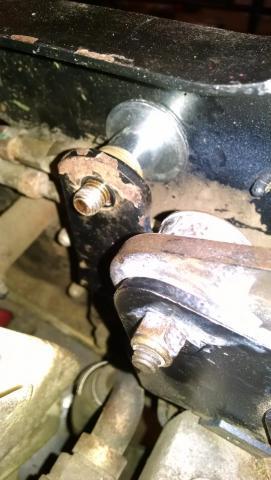

fatboycowen 31 #1 Posted September 14, 2014 (edited) So, i decided to rip this thing apart further, and figure out how this smart turn function works. I removed the seat and the fender. It's actually pretty simple, and all mechanical. In the front, when you turn the wheel, there is a lever, that drives a rod. When properly adjusted (mine is WAY off), when the wheel is straight, the rod is pushed all the way back. The first photo shows how this affects the rear. That rod holds this piece down when it's pushed back. Picture 2 shows the position of this piece when the rod is all the way forward. When the rod isn't all the way forward, it basically limits the transmission input position. Unfortunately, if you just disconnect the rod (like the previous owner did), the gold part in the picture wants to pull itself up when you step on the motion control pedal, and basically permanently enables smart steer. Mine was so out of whack. It's going to be so much faster when i fix this. So, my question is, why not disable the smart turn system back here, rather than way up front? It seems i could simply weld the sliding piece in the photo to the guide it slides in, which would keep the smart steer in full speed permanently. If i didnt want to weld, i could make an L shaped piece of steel with a slotted hole, and bolt it through, which would hold this lever down, and keep it at full speed. Is there anything wrong with that approach? It seems so much simpler than goofing around up front. Edited September 14, 2014 by fatboycowen Share this post Link to post Share on other sites

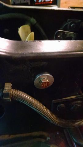

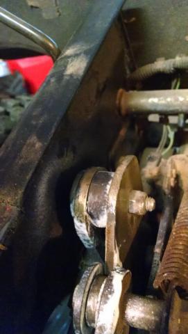

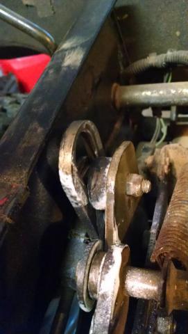

fatboycowen 31 #4 Posted September 15, 2014 Alright. I found a really easy and cheap way to do this, i think. I haven't tested it yet. SIMPLE! Totally reversable too. Only simple tools needed. So, the smart turn linkage at the front, drives a rod to the rear. The rod at the rear attaches to what you see in the photo (actuator arm of some kind, not sure what it's called. There happens to be a 1" hole in the frame RIGHT where the linkage connects, when the smart turn is OFF. I assume it's for removing the bolt. It's perfectly placed. It's so simple, it's crazy. Here is all you have to do: Pull the rear fenders. I did it myself, but a second person would have been nice. It's easy mechanically. Be careful of the fuel tank. It's kinda loose. Don't jarr it to much. It won't fall off unless you are real ham fisted with it. Disconnect the smart steer in the front. Right behind the firewall. Turn the steering wheel and watch what happens to get an idea what needs to be disconnected. It's just one bolt to pull. With the rear fenders off, the metal screens (sides and front) under the dash come off very easily with screws. The access is easy. Find the linkage in the pics. Disconnect it. Buy a 3/8" bolt, 2 to 2.5" long. Buy a steel spacer. Mine is 3/4" long, 3/4" OD, 3/8" ID. Buy some heavy duty fender washers and regular washers. The order of my assembly is as follows, from the side of the frame, inward. Bolt Fender washer Frame Fender washer Spacer 2 washers - to fill the space almost perfectly between the frame and the actuater arm thing (important, don't want to bend that arm when the bolt is tightened). Arm thing nut fit it up, and tighten it down. Make sure the actuator rod you disconnected is out of the way (above). The fender washer squashes in a bit, which will help prevent it from moving back and forth in the larger frame hole. I tightened mine down real hard. Then, i had to zip tie the actuator rod above the spacer. If it's loose, it could fall down and interfere with the motion control actuator, which could be real bad. Another option is to remove it entirely, which i may do later, once i determine that this works. The motion control linkage works perfectly now, and gives the transmission input full range, no smart turn. When the tractor is in neutral, the motion control lever operates as normal. I think the parts were like $5 at the local hardware store, maybe less. The spacer is like $2.90, which is the only "expensive" part. Hope this helps other owners. I'll report back once i test it. Jon 2 Share this post Link to post Share on other sites
fatboycowen 31 #5 Posted September 15, 2014 Another note: I originally intended to leave the actuator rod in place. But, i bought too thick of a spacer. You could do that. 2 Share this post Link to post Share on other sites

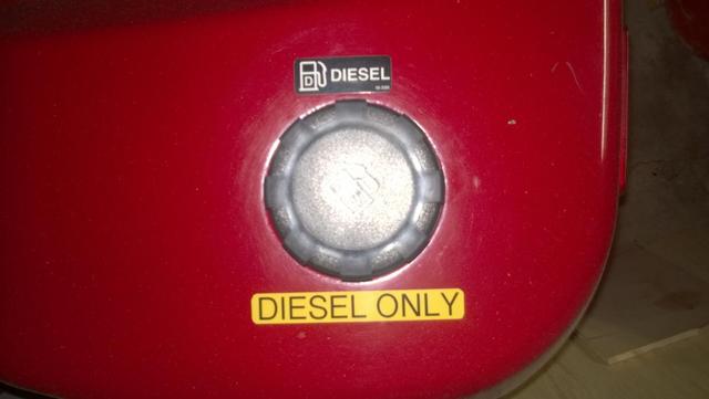

shallowwatersailor 3,222 #11 Posted September 17, 2014 Hey John, Color code (paint it red) the fuel cap on the diesel. Not 100% mistake proof but better than leaving all of them black Of course, it will be of no help if you mix up the fuel cans at the gas station Hi Don, Actually I added another label. The black one is from Toro and the yellow one is mine. I bought a nice No Spill diesel can as well. After I bought it, I spent an afternoon trying to cross reference a yellow molded cap seeing as Toro makes diesel Ground Maintenance equipment but no luck. I have also noticed that there are Green caps for diesel fuel now as well. Is that due to Bio-Diesel fuel? John 1 Share this post Link to post Share on other sites
