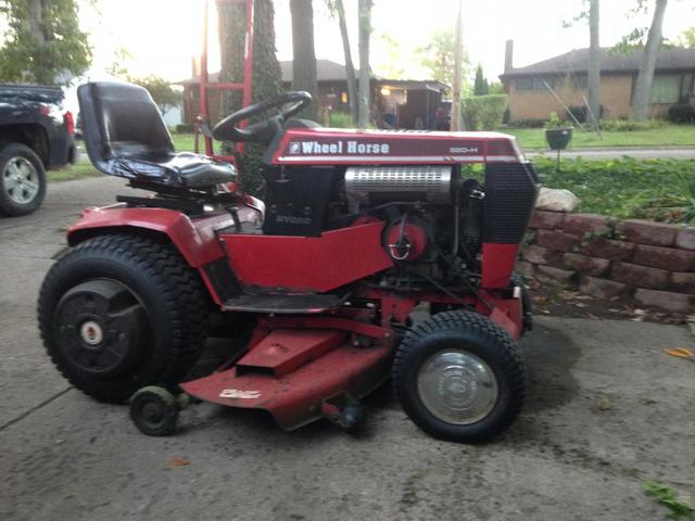

Dhodge 530 #1 Posted September 14, 2014 Brought home 520H #3 yesterday. I must have a hole in my head for bringing home another Wheel Horse. I think this makes 27 total now and I cant stop looking. Anyhow I went to an estate sale yesterday and found this 1989 520H with a 48" deck, plow, chains, wheel weights, mid mount grader, tiller and a pull behind spreader. Needless to say it found it's way on my trailer and to it's new home. It was running rough and initially I was thinking that it might be running on one cylinder. I sprayed a little water, from a squirt bottle on the cylinders with the engine running and got steam from each one. So I determined she's running on two. Then I sprayed a bit of starting fluid on the front cylinder and nothing changed, so I sprayed some on the back cylinder and she smoothed right out for a moment, so today I get to replace a head gasket. All in all it's in pretty good shape and should make an awesome snow removal tool this winter. It came with 4 really nice hub caps that should look really nice on one of my Suburban's or RJ's. My goal is to have a 520 for mowing, one for snow blowing and one for snow plowing without having to change attachments or maybe my goal is just having one more to tinker with who knows. Like I said---hole in the head. 5 Share this post Link to post Share on other sites
