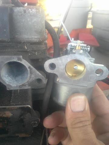

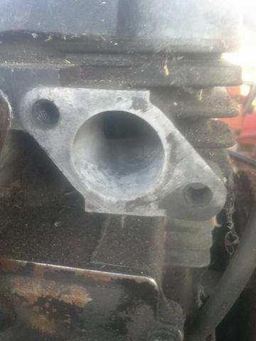

Wayne 28 #1 Posted September 14, 2014 got my h60, was advertised on ebay as good compression, no carb. perty lil black thing (will be red soon enough) well, it's true but should maybe have read no carb, manifold, or control mounts. my main question at this point is about the intake port... it is fully twice the size of carb. I am asuming that there should be some kind of manifold to rotate the carb 30-45 degrees? did i just get sent the wrong carb? must be 25 years since i have worked on one of these engines, can't remember. again, intake port seems HUGE. carb doesn't fit. Share this post Link to post Share on other sites

chazm 413 #3 Posted September 14, 2014 Sorry to say,but wrong carb I believe this is the one you need Share this post Link to post Share on other sites
Wayne 28 #4 Posted September 14, 2014 Well, the good news is the company is out of Indiana with 100% positive feedback... maybe they will exchange it thanks for the info I will still need that carburetor flange right? Share this post Link to post Share on other sites
oldredrider 2,553 #5 Posted September 14, 2014 Yes, you will need the flange. I've seen them on Ebay. Share this post Link to post Share on other sites
Retired Wrencher 6,814 #6 Posted September 14, 2014 (edited) Carb # is 631828 and in these picks u can see in the first pick is the gaskets. the second pick is the Flange # I hope this helps. Gary B... Edited September 14, 2014 by T1257 Share this post Link to post Share on other sites
Wayne 28 #7 Posted September 14, 2014 (edited) assuming that 30195A is a part number... not sure of the number shown on the toro parts site, I didn't write it down, because it said "not available" so, in light of this, i will google 30195A thank you Heh, read text again... my reading comprehension used to be pretty good... they say the mind is the first thing to go Edited September 14, 2014 by Wayne Share this post Link to post Share on other sites
