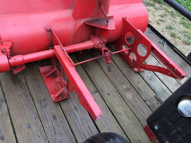

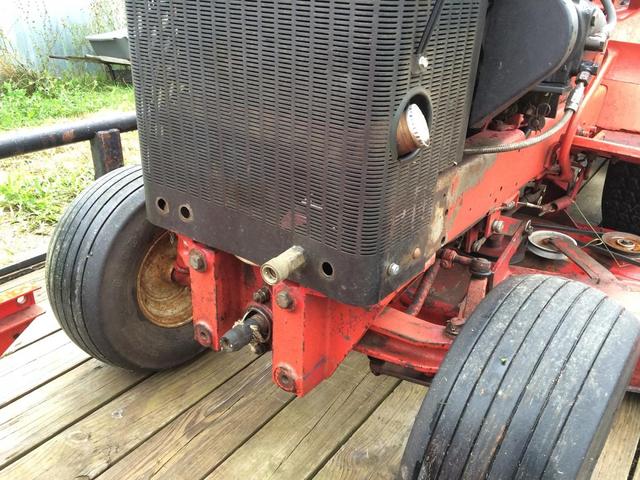

dan-d250 3 #1 Posted September 11, 2014 Trying to figure out where to start to attach my snowblower to my d250 , I am looking for maybe some pics of what anyone else may have done etc ... will attach some pics need to find a pto knuckle , and hydraulic attachment to raise and lower it 4 inches or so .... and some sort of frame to attach to the tractor .. any help is gfreatly appreciated .. thank you Dan. Share this post Link to post Share on other sites
baerpath 517 #2 Posted September 11, 2014 It would be easier to get a snow blower made for a D250 with the correct parts Share this post Link to post Share on other sites
gwest_ca-(File Mod) 12,463 #3 Posted September 11, 2014 You may get something from the ipl. The SX model is for the D-250 10-Speed. The 48" ST is for the D-Series Auto models. Sorry we don't have an operator manual for this series of snowthrower. I believe the original was supplied by Haban and the basic unit was also used by International Harvester and Bolens. Garry Share this post Link to post Share on other sites
