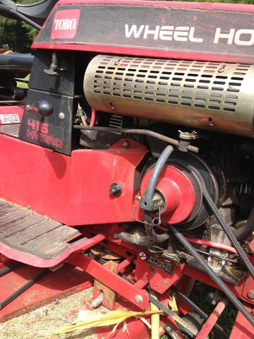

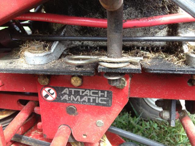

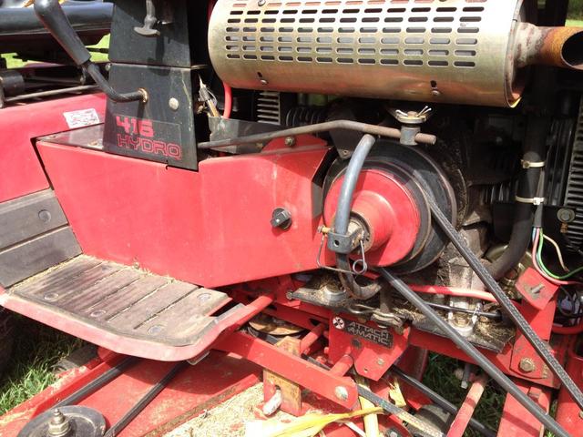

km3h 543 #7 Posted September 10, 2014 Here you go. This is a close up of the way it is set up on the bottom. This is a photo of the clutch engaged. Here it is disengaged. Share this post Link to post Share on other sites

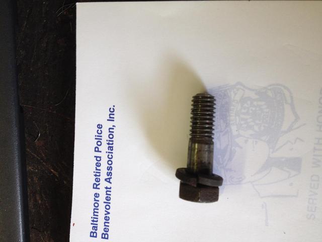

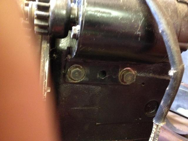

km3h 543 #11 Posted September 22, 2014 Scott I am sorry about that. I got sidetracked and forgot all about it. On my Kohler 14 HP engine the bolt is 3/8 X 1 1/2 inches course thread with a lock washer. It does not appear to be a tapered bolt and I think any bolt of the above size and thread will work. Let me know how this works out for you. Share this post Link to post Share on other sites

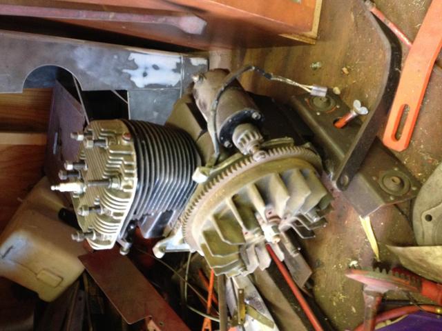

km3h 543 #13 Posted September 22, 2014 That engine is out of a 1978 Case 444. I have it torn down and awaiting some paint before I put it back together. I have already rebuilt the engine. Glad the photos helped. Share this post Link to post Share on other sites
