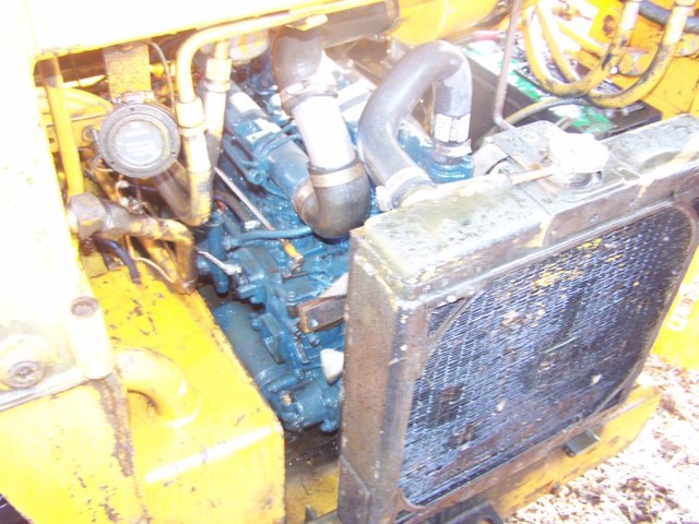

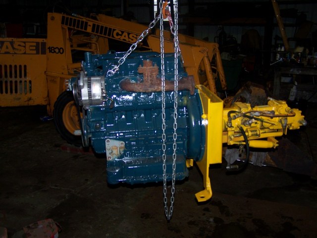

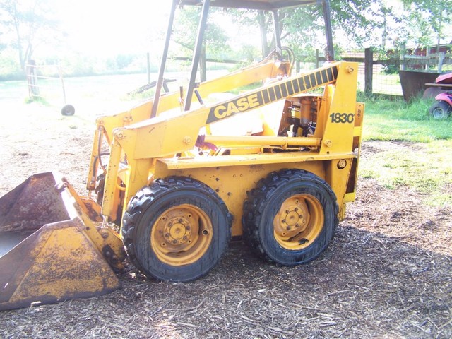

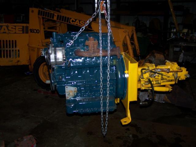

546cowboy 302 #10 Posted September 10, 2014 Here is my gas to diesel swap done out of necessity. What could I do? You cannot find one of those 32 hp. Renault motors and the skid steer was under powered any way. If you think it costs too much to put a 10 hp. in a Wheel Horse, well you don't want to know what it cost me to put that 51hp. Kubota in this thing or the mods I had to come up with. 1 Share this post Link to post Share on other sites
