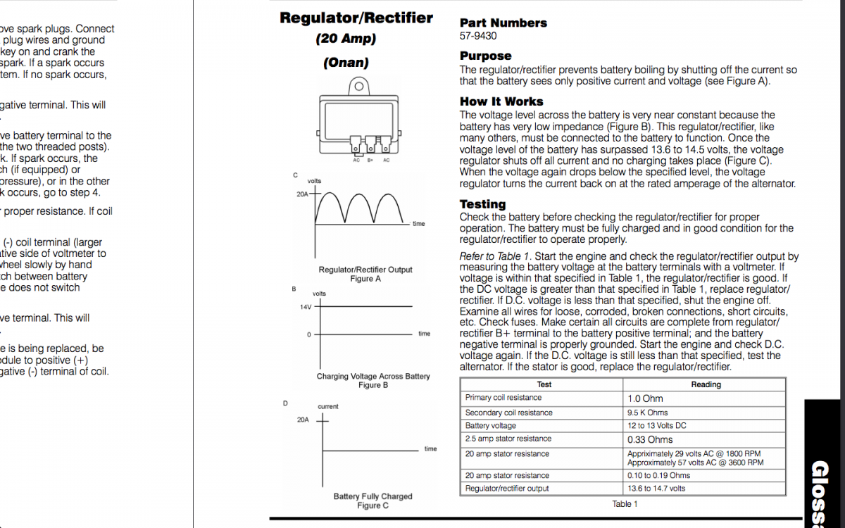

Martin 2,135 #5 Posted September 7, 2014 (edited) heres the method for testing the regulator from the demystification manual...... nick posted a source for the fuse block, terminals and for the regulator..... if you want an oem regulator, it can be bought new here...... http://onanparts.com/index.php?main_page=product_info&cPath=1_11&products_id=99 Edited September 7, 2014 by Martin 2 Share this post Link to post Share on other sites

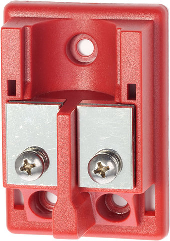

Save Old Iron 1,576 #13 Posted September 8, 2014 Dave, if you going to rewire your tractor, I might suggest looking into the "MAXI FUSE" style of fuse holder for the 30 amp fuses. These are a holder / fuse combo that are intended for reliable high amperage connections. The fuse actually bolts onto a substantial fuse holder and provides a long term reliable connection. Just as the high current compromises the fuse holder, the 9 pin engine harness connector also suffers from degraded connections on certain pins within the male / female MOLEX connector. You will most likely see evidence of heat stress or aging of the plastic housing on the engine harness connection also. There are several posts which point out sources to purchase replacement pins and connector shells for this area. 1 Share this post Link to post Share on other sites
Dave H. 15 #14 Posted September 8, 2014 (edited) Good Morning SOI, Thanks for the Maxi Fuse information. Yes indeed, these fuse holders appear to be rock solid and fit for high amp usage. This a great lead SOI. Many Thanks! http://www.bluesea.com/products/5006/MAXI_Fuse_Block_-_30_to_80A Edited September 8, 2014 by Dave H. Share this post Link to post Share on other sites
