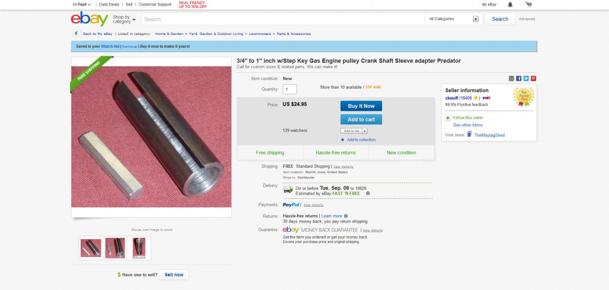

pfrederi 21,303 #9 Posted September 5, 2014 Wayne : Welcome. My L107 (see avatar) was purchased by my father for $479.35 on 27 May 1967 and has been in use ever since. She currently has a HH70 Tecumseh (got that as it has compression release made it easier for my father to start her as he got older). The original engine got new rings and is sitting on the shelf ready to go back in action. On your new motor...rings and a cylinder hone maybe all it needs. Parts are available. The H60 did not have replaceable sleeve bearing on the crank..the HH series does. The valve guides are not replaceable you ream them out to use a repalcement valve with an oversize stem. The service manual for Tecumsehs is here in the manuals section Many, if not most H60s had 3/4" Crankshafts...you need a 1" shaft to fit your drive pulley. I saw this on ebay might be something you could use or copy. They are great tractors mine is my favorite of 13 horses. 1 Share this post Link to post Share on other sites

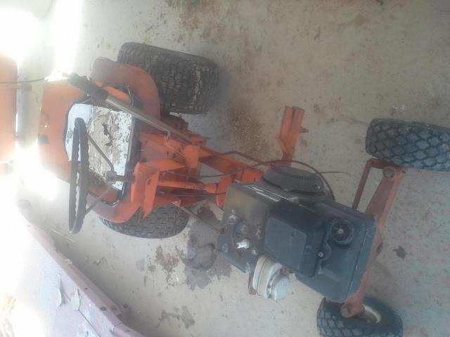

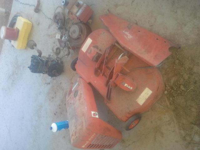

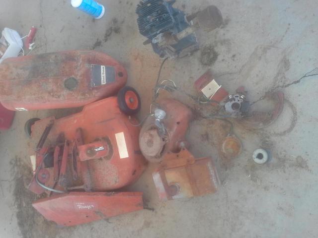

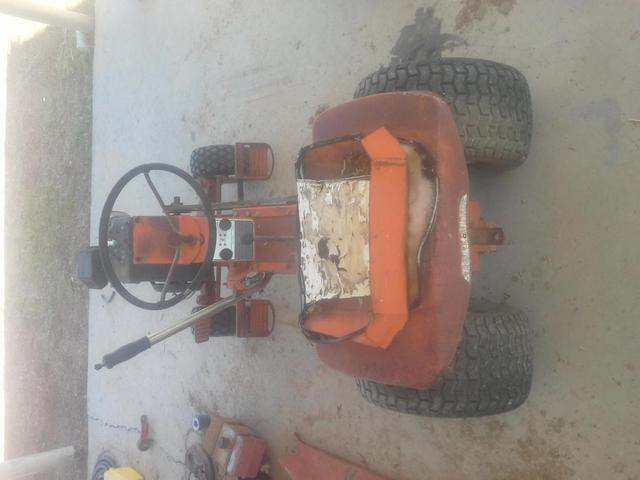

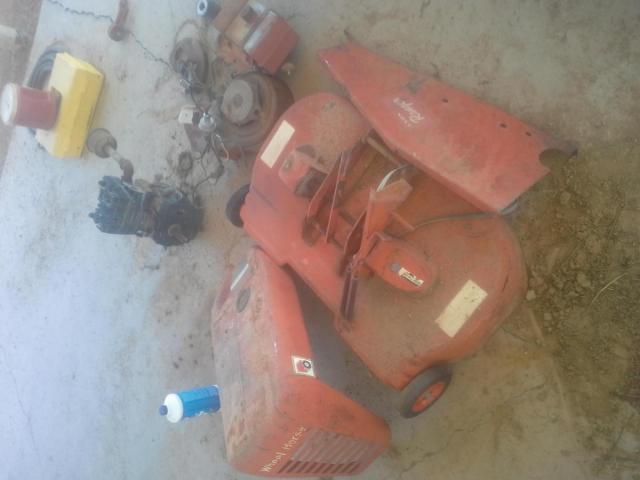

Wayne 28 #10 Posted September 5, 2014 Wow, so many friendly replies and so much useful information in less than 24 hrs.! Thanks all! I think I will like it here... guess i better go get a pic. or 2 of the various parts in the car port . poor old tractor really needs some tlc. I have decided for right now, I am going to install the new engine, make it run and get to mowing. I plan to tear it down,remove dents, and paint it this winter, but right now i need it to work (mow) 1 Share this post Link to post Share on other sites

Wayne 28 #12 Posted September 5, 2014 forgot to mention I added a briggs (craftsman) 5 hp and a push bar to move disabled cars into the shop. push bar has since been removed and recycled for another project. Share this post Link to post Share on other sites
