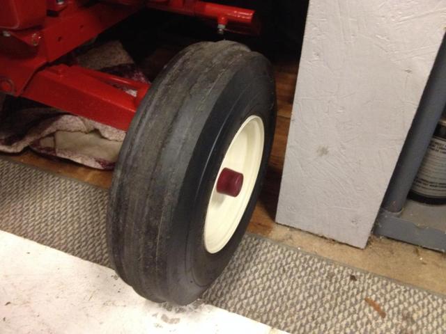

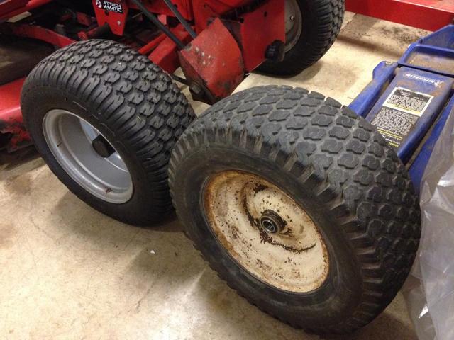

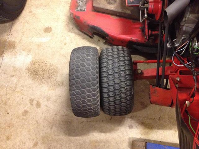

Martin 2,134 #8 Posted September 1, 2014 heres a few pics for you..... deestone 4.00 x 8 on early rims (3.75 wide) 16 x 6.50-8 on early rims c series beige colored (3.75 wide) and 16 x 6.50-8 on later 5.38" wide rims silver colored 1 Share this post Link to post Share on other sites

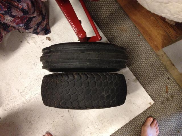

scotty 252 #9 Posted September 1, 2014 Pictures with the tire on the rim just like martin. Is there much of a height difference in 16x6.50-8 and 4.00-8? Thanks those were just what I was looking for! Share this post Link to post Share on other sites
Martin 2,134 #10 Posted September 1, 2014 16 x 6.50-8 on early rims and 4.00-8 deestone d401 on early rims...... 1 Share this post Link to post Share on other sites
