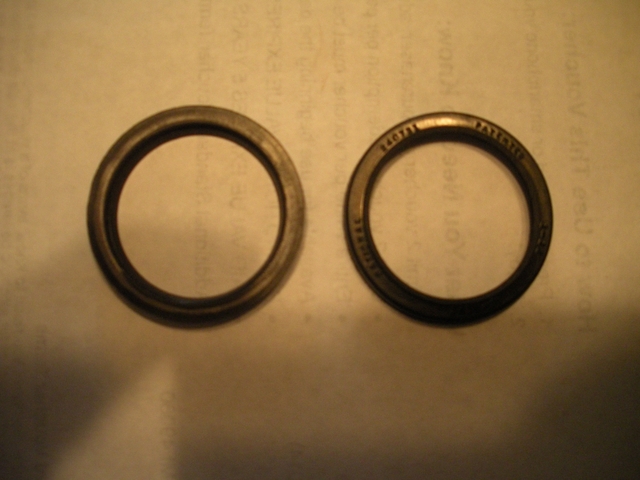

Hossenfeffa 49 #1 Posted August 30, 2014 (edited) Which is the proper way to install these seals. They are different than the originals that cam out.Number side in towards bearing or out?Number side up is on the right Edited August 30, 2014 by Hossenfeffa Share this post Link to post Share on other sites

stevasaurus 23,816 #3 Posted August 30, 2014 I would take a look at the rubber seal. If it is straight, it will not matter. If it is angled, I would put the angle toward the inside. Can't tell in the pictures. On my boat trailers, the numbers are out. 2 Share this post Link to post Share on other sites

rmaynard 17,548 #5 Posted August 30, 2014 I don't know what seal you have there, but the SKF brand axle and brake shaft seals that I have been using have a spring on the inside. If you see a spring, that goes in. 3 Share this post Link to post Share on other sites
Hossenfeffa 49 #6 Posted August 30, 2014 The seal angles down towards the number side. No spring. Share this post Link to post Share on other sites

stevasaurus 23,816 #8 Posted August 30, 2014 Bob's right about the spring. I enlarged your picture. You want the numbers out for that seal. Share this post Link to post Share on other sites
Hossenfeffa 49 #9 Posted August 30, 2014 To late, went in with the numbers facing in, we'll see if it leaks.At least the hubs will come off easier next time. Also, next time I will look for a seal that is easier to tell which way it goes in Share this post Link to post Share on other sites

doc724 927 #14 Posted September 1, 2014 Here is the reason why you put the lip in or out. If the fluid to be sealed is pressurized, put the lip in toward the fluid. The pressure will work against the seal to make it tighter. If you put the lip out and it is in a dirty environment (like a tiller), dirt, string and wire will eventually get under the seal and it will leak. Tillers by the way have two seals per shaft, one facing in and one facing out and they are installed in a preferred order. WH transaxles have the lip always in. That way you can get behind the steel shell with a dental pick and pry put the bad one and install a new one without splitting the transaxle. Not so easy to do if the lip is facing out. Also, you will need a special install tool to bear on the steel shell only and not the rubber if you put the lip facing out Share this post Link to post Share on other sites
