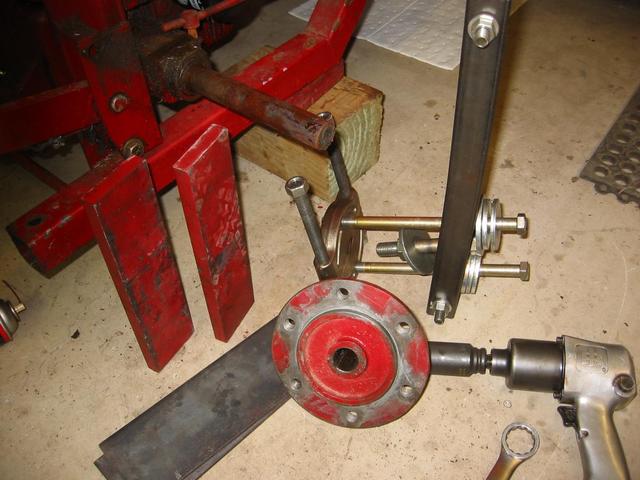

pfrederi 21,091 #29 Posted August 30, 2014 If your making a homemade puller use a fine thread bolt instead of a coarse one. It will provide a lot more pulling power and with more threads per inch the threads won't pull apart. If you look at a gear puller ,all of the threads are fine. Fine threads are better. However Acme threads are even better yet (you can get acme threaded rod and nuts from McMaster) 1 Share this post Link to post Share on other sites

stevasaurus 23,812 #33 Posted August 30, 2014 pfrederi (Paul)...that is one serious puller you made there. Thumbs up mate!! 1 Share this post Link to post Share on other sites

pfrederi 21,091 #38 Posted August 30, 2014 pfrederi (Paul)...that is one serious puller you made there. Thumbs up mate!! It worked...finally. That is not an optical illusion I bent the 1-1/2" thick wall tubing in the process of removing the hub. D hubs are the worse. 1 Share this post Link to post Share on other sites
AMC RULES 37,259 #39 Posted August 30, 2014 WOW! You weren't kidding Paul. Share this post Link to post Share on other sites
