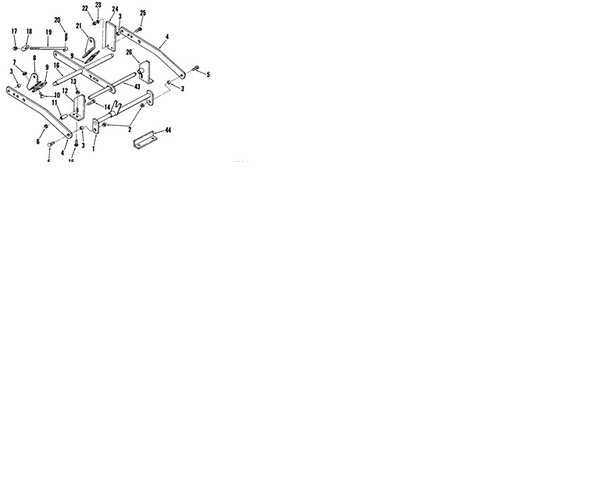

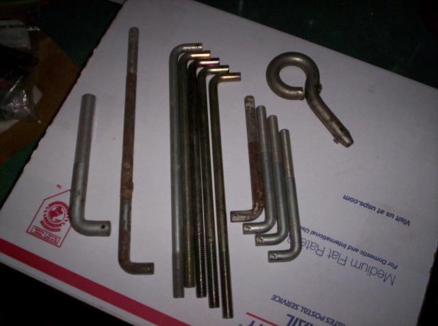

groundhog47 448 #5 Posted August 31, 2014 What particular mower deck is this for? If it happens to be the type I have I'll get a detail for ya. Hoping it will be similar to something like these pictured... Share this post Link to post Share on other sites

jambur 0 #7 Posted September 1, 2014 Groundhog47 I am going to use a 42in SD I wont have the serial number until I get home (camping) but I believe it is early 80's off a gt1600. Your pics look like there might be one in there for a measurement. I will keep my fingers crossed thanks Share this post Link to post Share on other sites
groundhog47 448 #8 Posted September 1, 2014 (edited) Groundhog47 I am going to use a 42in SD I wont have the serial number until I get home (camping) but I believe it is early 80's off a gt1600. Your pics look like there might be one in there for a measurement. I will keep my fingers crossed thanks Bright rods 102385, 3/8" dia from back of L to beginning of threads 6 5/8", overall 8 5/8" (shows as pn 19 on some 05-...mowers). There is also a 102035 rod listed as 19 on some, don't have measurement, but could be the heavier thicker rod (rusty or zinc colored one(s) on left of pic. Hope this'll aim you in the ballpark infield. Ref: Toro Consumer parts search>>>05-42MS01, 42" Side Discharge Mower, 1980 Looks as if my terminology is incorrect on what nomen./apparatus you are hunting part. Edited September 1, 2014 by groundhog47 Share this post Link to post Share on other sites
jambur 0 #9 Posted September 2, 2014 Thanks for the mesurment. It will get me started In the right direction. Share this post Link to post Share on other sites
