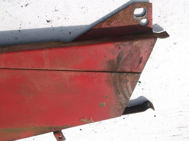

Martin 2,135 #27 Posted August 23, 2014 not all my mechanical transmission tractors have a belt tab like you guys mentioned. i don't think my 1057 has one and the clutch works fine. what is important though is how the belt guard fits. the bottom of the guard holds the slack when the clutch is engaged. as it is keeping it flat the excess belt comes away and out of the engine pulley and the belt stops moving. the belt guard should have a finger sticking forward from the front of the guard to hold the belt in the pulley right at the point it starts to curve around it. that way when the slack is there the belt is forced away from the circumference of the pulley and it disengages. you can see the fingers in Eds pic of his guard here. they stick out where the engine pulley position is... Share this post Link to post Share on other sites

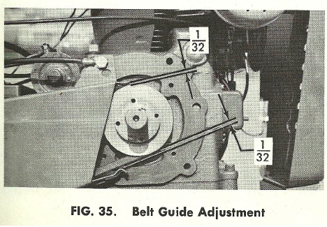

rmaynard 17,643 #29 Posted August 23, 2014 When the guard (cover) is in place, the end that attaches to the engine should have these tabs. With the clutch pedal released, and the belt pulled tight, each tab should be about 1/32 of an inch from touching the belt. 1 Share this post Link to post Share on other sites
