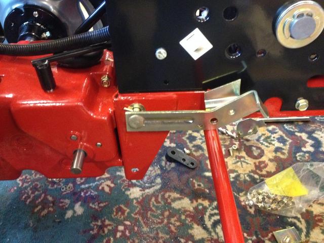

JEGibbs 11 #1 Posted August 23, 2014 Raider 14 with 6 fwd 2 rev I had the drive belt break today. took it to the parts house and bought a new belt. The new one is 1/4" longer than the old one. They don't carry fractional sizes. It went on tight like a new belt should but now, randomly when I stop to change gears, it's like when the syncros go out in an old ford. The gears grind a little or it doesn't want to come out of gear and stop. The brakes are also pitiful. It seams like there isn't any "feather" left in the clutch. Keep in mind this isn't every single time but it's at least 50% of the time.What am I doing wrong? Share this post Link to post Share on other sites

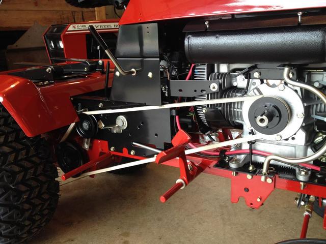

Martin 2,133 #13 Posted August 23, 2014 (edited) the tensioner pulley is called an idler. the tab on the top of the idler is a close fit, you should have about a 3/16 to 1/4 gap between the tab and pulley. the pulley needs to be removed to install the belt. its a bit hard to see here but this is how the belt should be with the guard removed, i will try and find a close up pic of the tab and idler.... Edited August 23, 2014 by Martin Share this post Link to post Share on other sites
JEGibbs 11 #14 Posted August 23, 2014 Hey Martin! Thank you. Now that I'm speaking the same language as you all I understand. The Belt guard (tab ,not the actual safety guard that bolts to the fender) Is like 3/4" above the Idler pully. Thats my problem then. See, I was taught that Idler pullies just spin and maintain belt tracking while tensioners keep tension and engage things. I didn't have to remove that tab to install the belt. It slipped right in. I didn't know to look for that. Thanks guys. I will adjust that and report back Share this post Link to post Share on other sites

Ed Kennell 45,799 #16 Posted August 23, 2014 It's a gates B79 belt. The only info i can find is it is classified as a b section. are the toro 7473 and gates 7473 the same belt? because the diminsions are the same too. Also there was a tab on the tensioner pully. there isnt an idler pully on my tractor. Is there a tab on the large sheetmetal belt guard that lines up with the tensioner? What you are calling the tensioner pulley is what I called the idler pulley. Yes there should be a tab on the belt guard just forward of the tension pulley when the clutch is depressed. The belt should ride above the guard tab and below the pulley tab. OK, I took a couple pics of my Raider 14. The bottom pic is with the clutch depressed. You can see how the pulley tab would pinch the belt agajnst the tab on the belt guard if it were in place. Share this post Link to post Share on other sites
Martin 2,133 #17 Posted August 23, 2014 (edited) the tab should be at right angles to the 'tensioner' arm..... this is what you are calling the belt guard, correct? if so you still need to have the belt cover (large cover that covers up the whole belt path) on as well for it all to function as it should....... Edited August 23, 2014 by Martin Share this post Link to post Share on other sites

Ed Kennell 45,799 #20 Posted August 23, 2014 No race here Martin. I just happened to have my Raider apart to show the two tabs. Hopefully JEGibbs will be the winner. One other thing I do to these two tabs is to increase the bend where the belt enters and exits the tabs. Make sure they are smooth with no burrs as they will wear on the belt covering. 1 Share this post Link to post Share on other sites

Ed Kennell 45,799 #23 Posted August 23, 2014 Is there a tab bolted to the side plate as shown on Martins first pic? Not sure what year Raider you have, but maybe WH changed the design and moved it from the belt guard to the side plate, which is a much better design, as you can check and adjust the clutch operation with the belt guard removed. 1 Share this post Link to post Share on other sites
