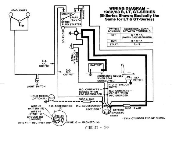

Kristi M Mitzel 0 #1 Posted August 23, 2014 hi my name is krissy and I need help on hooking my solenoid in my toro work horse, please let me know if anybody can help me thank you[emoji29] Share this post Link to post Share on other sites
rmaynard 17,659 #2 Posted August 23, 2014 Please provide the ID number of your Work Horse if you have it. Then we can find a wiring diagram and see what we can do. Share this post Link to post Share on other sites

km3h 543 #12 Posted August 24, 2014 Here is a schematic of your wiring. I believe you have a three post solenoid on that tractor. One heavy wire comes from the battery to one side of the solenoid. The other heavy wire goes to the opposite side of the solenoid. A smaller diameter wire runs from the start position on the key switch to the peddle safety switch then to the center pole of the solenoid. Share this post Link to post Share on other sites
Kristi M Mitzel 0 #13 Posted August 24, 2014 yes,then there is another wire that connects to one or the other, witch I'm not shore of? Share this post Link to post Share on other sites
km3h 543 #14 Posted August 24, 2014 I left out that the second heavy wire goes directly to the starter. Share this post Link to post Share on other sites
Kristi M Mitzel 0 #15 Posted August 24, 2014 thank you, you don't have any video how to hook it back up do YOU, I know sounds crazy don't it.... Share this post Link to post Share on other sites
