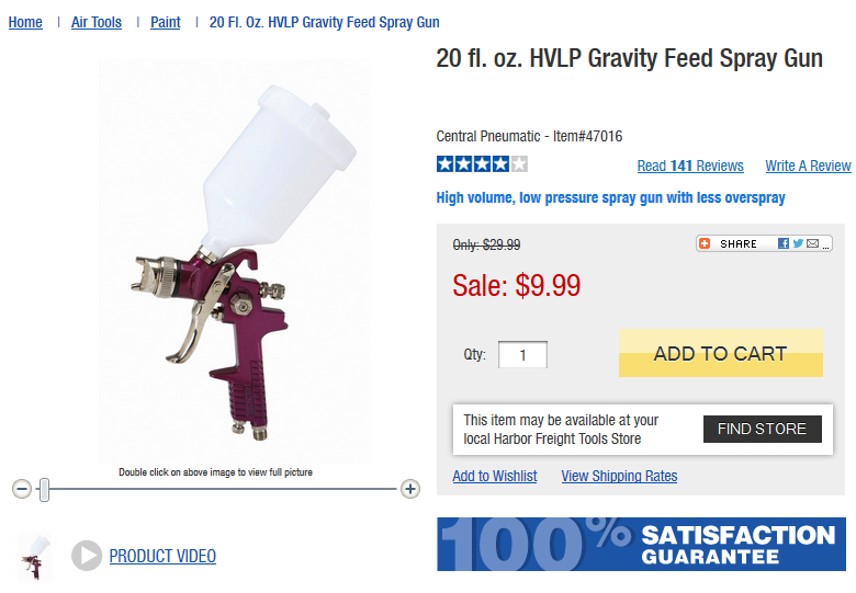

rmaynard 17,634 #1 Posted August 23, 2014 From time to time we all have entered into the discussion of "what do you use to paint with?" . Well, the Harbor Freight HVLP gun always comes up. I have said, any time they go on sale, I pick up a couple. It's easier and cheaper to just throw them away than to spend money on lacquer thinner to clean them, not to mention the time involved. This weekend Harbor Freight is having a "Yard Sale". Here is what I got. Then I presented this: So, bottom line is $9.99 less 25% = $7.49 each. I bought four of them. I had 4 coupons, and I had to go through several different registers to get my discount, but it was worth it. 5 Share this post Link to post Share on other sites

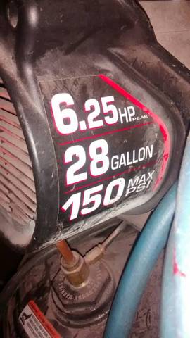

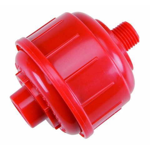

rmaynard 17,634 #9 Posted August 23, 2014 I've only ever used rattle cans because I don't have an elaborate compressor set up with an air dryer moisture remover gizmo. Are they required to use the HB HPLV guns? Jim, I don't use anything special. My old compressor is just a 6.25hp, 28 gallon, 150 psi. I use disposable moisture filters. The compressor runs a lot, but seems sufficient to power the gun. 2 Share this post Link to post Share on other sites
