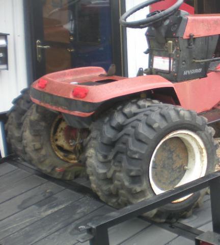

Another question, anyone have experience with using the these skid steer tires?  These were on one I brought home yesterday.  Would they be better or worse than the ag tires?   :eusa-think:
post-13404-0-36495700-1410270689_thumb.j
CasualObserver
Geno,  aren't you putting way too much thought into this one?  You live in Kentucky. What's your average snowfall per event... or even all winter? weathermansnow.gif
If you're really that concerned.... you have enough tires to have a pair ready for each situation. Start with Ags or Turfs without chains...if you get stuck, jack it up, swap a pair with chains on and go. It's only 10 bolts to swap them out.
  • Like 1
Geno
I put too much thought into everything, I have OCD remember.  :laughing-rolling:   I don't just say that either, I have papers from a shrink from over 20 years ago.  :eusa-doh:
Sometimes we get very little snow, sometimes several feet, I've seen drifts at the shop over the hood of my trucks.  The past 2 years as soon as I got things cleared it would snow a day or 2 later.  I just want to have the best ready for anything when it happens.  I have a lot to choose from so why not.   :laughing-rolling:
